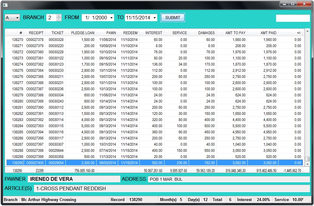

I wish to have FOOTER property just like HEADER property on a GRID/BROWSE control to put some TOTAL or REMARKS in it. Tnx and more power HMG!!!
i have a screenshot here with 138290 records. I used GRID as a footer to recalculate all the FIELDS on the BROWSE control. The problem is it will not move if i had to add another FIELD to my BROWSE table. I want my FOOTER will move LEFT to RIGHT as I move my KB Left to right. Hi to all!!!

What I do to get around this is to create a temporary table and append the fields or all fields from
the main table. I then append a blank record and give the first field the name total or what ever.
I can total columns to put the totals in the numbered records. This works good. I also set relation back to main table sometimes.
Not sure what your doing but works great for reports.
Regards Franco

you could put the total fields into variables, and put labels right below the grid.
this way you would have much control on what is there.

What I do is put another Grid in a single row without headers to put there totals or averages depends on what you want, down the other and it looks like one !!!. And it's the same speed as working with grid or Browse !, although I admit I have not worked with large data bases. Maximum 10,000 as evidence.
