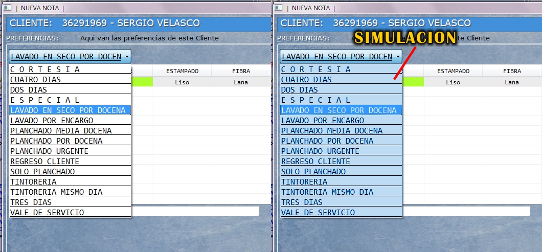

This is very old demand... and not only for ComboBox, Datepicker, CheckBox ( check character "Image" ) has same problem. :(
I made in this way, it's no the better way but it can be dribbled putting an image in place.

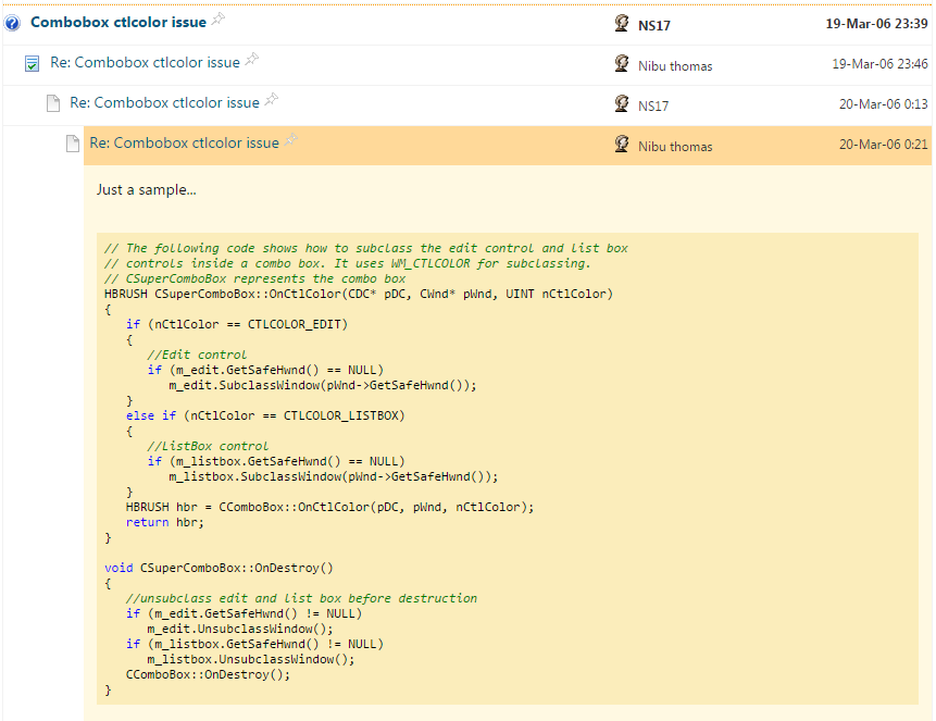

But I found something that ncould help to Claudio, in case one day he can set fontcolors/backcolors to these controls.
Because seems be posible (but unfortunately, I'm not able to do for lack of knowledge in C). see below:
Here it's the link of it.
I also I have read this:
http://www.codeproject.com/Messages/141 ... issue.aspx
It's very frustrating not being able to control the colors of the controls :( maybe someday ... :roll:
