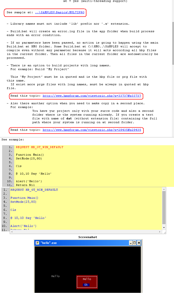

I believe we tried to keep in html file, because quite all HMG product are present source codes files and in DOC keeping in html makes easy for maintenance and updating proposes.
It is also important to mentioned that are two ways (localhost and hosted) to access DOC. When I said localhost, we access for example at C:\hmg.3.3.1\DOC\hmgdoc.htm and in hosted way at hmgdoc/data/index.htm
So by this does not means that we should have two versions of DOC, because in all html you need to specify the full path a file names of each topics. So then I made a routine which can differantiate when in localhost when is hosted. (See Building_HMG_applications.htm in attached file at GetMyURL)

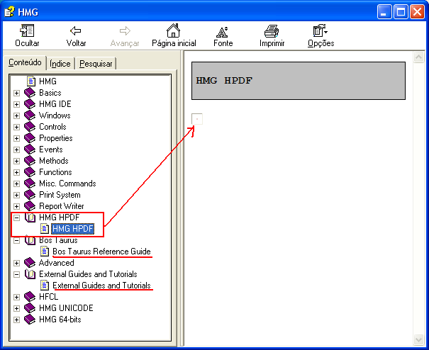

I downloaded your chm file and I've runned and in three itens I saw without descriptions of each topics. See image below:kcarmody wrote:This HTML file set is very close to what would be needed to create a real CHM file, so I took a few hours to do this. I've put the result on my site at http://kevincarmody.com/hmg/DOC/

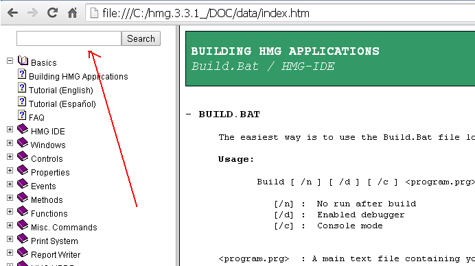

Yes you are right Kevin, by chm it is easier than make thru htmls. I tried to implement the search engine into hmtl file. This I have not finished because it is hard to implement and I also have not much knowledge in html but you can find something in attached file in my navigator.htm one.kcarmody wrote:was surprised to see that the HMG Reference in the DOC directory is a group of linked HTML files. There is a master file, index.html, that makes this set of files look and behave something like a CHM file. But the big problem with this arrangement is that a CHM file is easily searchable, but a set of HMTL files is not

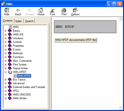

It should look like the attachment below. The button should open a PDF. Perhaps your CHM viewer does this when the link is broken. In XP it shows the button but the button does not do anything.Pablo César wrote:Hi Kevin,
I did not test PDFs properly when I posted my original message. Since then I discovered that they are difficult in CHMs. They have to be opened with a special button that is used to open external files or web addresses. The PDF cannot be included in the CHM but must be copied as an external file to a place that is accessible to the CHM.

I don't see this search box and don't see any option for it in navigator.htm.Pablo César wrote:Yes you are right Kevin, by chm it is easier than make thru htmls. I tried to implement the search engine into hmtl file. This I have not finished because it is hard to implement and I also have not much knowledge in html but you can find something in attached file in my navigator.htm one.kcarmody wrote:was surprised to see that the HMG Reference in the DOC directory is a group of linked HTML files. There is a master file, index.html, that makes this set of files look and behave something like a CHM file. But the big problem with this arrangement is that a CHM file is easily searchable, but a set of HMTL files is not
Let me emphasize that search is the crucial feature we need. As a new user of HMG, I had to do many searches through the HMG documentation. The lack of easy search was initially a big problem for me. So the main reason I made the CHM was easy search.
For some reason, Mr. PCToledo did not turn search on in his CHM, but I did in mine ("Full-text search=Yes" in the Options section of the hhp file).
A web site or a local file can do a server side search, like the search page for my site at http://kevincarmody.com/site/search.html, which uses Google to search my site. But a search of local files is generally blocked in a browser by its "sandbox", which keeps Javascript and everything else in an HTML file, whether server side or client side, from accessing the file system of the local machine. This is necessary to block malicious software. You can get the URL of the current file and other such info, but you cannot search other files on the local system.

Regarding full path and files names in html, it is just for locations of:
- Source codes examples, usually at SAMPLES folders. This is a great think to make available some more examples tied to the main theme of each topic. It make easy for understand and this could be done by simple URLs which could appoint to localhost or at website when this doc been accessed by internet at hmgdoc/data/index.htm
- Hosted pictures when some screen shots is necessary to be displayed, for example.
- Also a folders of examples can be opened in child window
This is my point of view and does means that must be like this. Whatever be done to make easy search in HMG documentation will be great. I have presented that materials in order to be evaluated for your implementations if you want.
