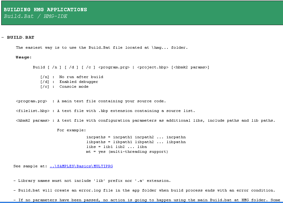

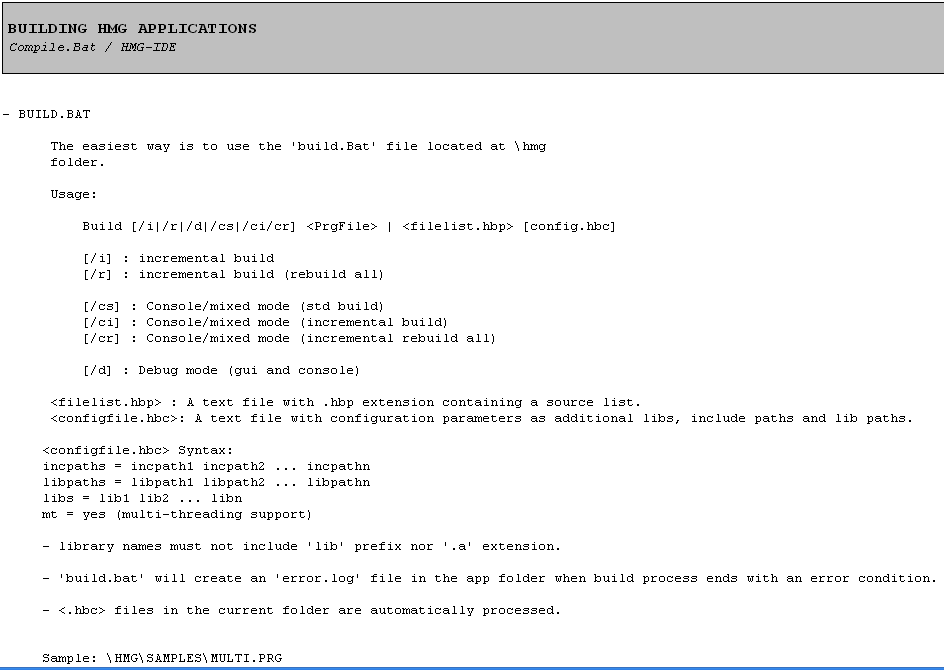

Error in HMG Reference
Thank you Kevin to for you advise regarding MEMOREAD/HB_MEMOREAD and MEMOWRIT/HB_MEMOWRIT. This should it be corrected.
By the way there is another correction that it could be fixed too.
Please note at this topic when I mentioned "Building_HMG_applications, some parameters was changed"
This:
Instead this:
