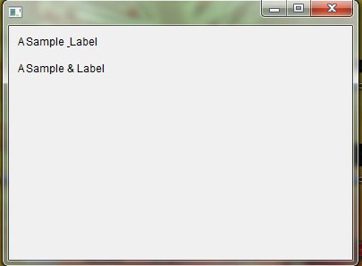

Re: Using & in a label
Wherever you want & inside label/menu control please use &&.
Consider this:
   define window x at 0, 0 width 400 height 300 main
      define label l1
         row 10
         col 10
         width 200
         value 'A Sample & Label'
      end label
      define label l2
         row 40
         col 10
         width 200
         value 'A Sample && Label'
      end label
   end window
   x.Center
   x.Activate

gfilatov
Posts: 1116
Location: Ukraine
Post by gfilatov »
Rathinagiri wrote:Hi,
Consider this:
Please be so kind to try also the updated sample below:
      define label l1
         row 10
         col 10
         width 200
         NOPREFIX .T.
      end label
      define label l2
         row 40
         col 10
         width 200
      end label
   end window
   x.Center
   x.Activate
