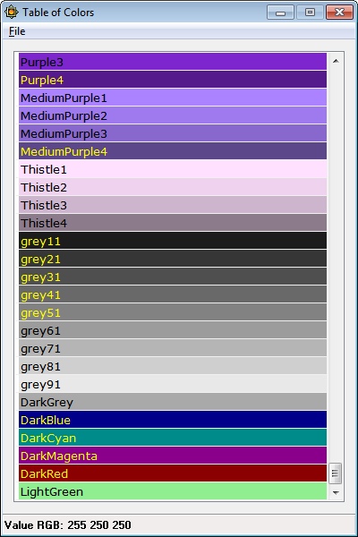

Please take a look for my old humble contribution adapted from MiniGUI EE to HMG.
It shows 455 colors in VIRTUAL GRID control. 8-)
ColorsTable.zip
Source files
(5.52 KiB) Downloaded 467 times

Screenshot

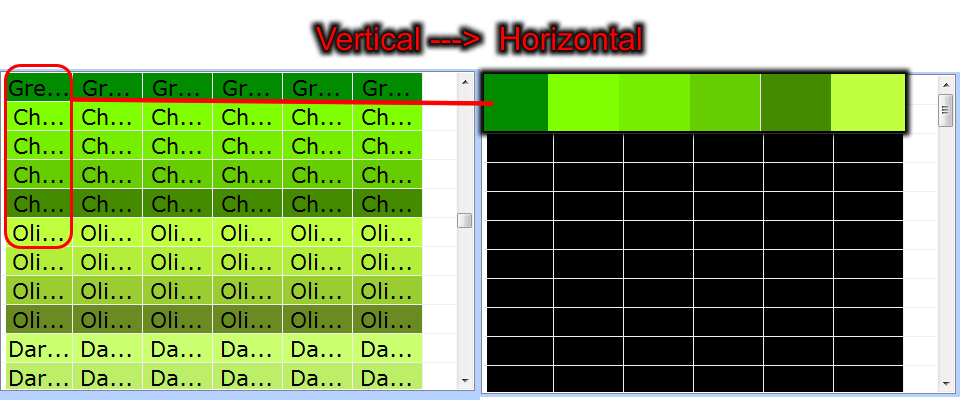

Hola
Tomando como base el ejemplo posteado por Gregory, quiero hacer que un GRID
contenga 6 Columnas, la primera, con un color base y las siguientes 5 con tonos
de ese mismo color. Pero me despliega solo celdas en color negro... Alguna Idea ?
Hola
Based on the example posted by Gregory, I want to make a GRID
contains six columns, the first with a base color and the next 5 tones
of the same color. But it only displays black cell in color ... Any Idea?
 * MiniGUI 'Table of Colors' Demo
 * (c) 2011 Grigory Filatov <gfilatov@inbox.ru>
ANNOUNCE RDDSYS
#include "minigui.ch"
Static aColors
static bColor1 := { |x,nItem| GetColumnBackColor( nItem ) }
Procedure Main
Local aData := {}
Local lInit := .f.
	SET MULTIPLE OFF
	aEval( ( aColors := InitColorsArray1() ), { |x| aAdd( aData, { x[1] } ) } )
	*aEval( ( aColors := InitColorsArray2() ), { |x| aAdd( aData, { x[1] } ) } )  // OK  !!!
	DEFINE WINDOW Form_1 ;
		WIDTH 500 ;
		HEIGHT iif( IsWinXP(), 596, 600 ) ;
		TITLE 'Table of Colors' ;
		ICON "DEMO" ;
		MAIN ;
		NOMAXIMIZE NOSIZE
		DEFINE MAIN MENU
			DEFINE POPUP '&File'
				MENUITEM 'Show Items &Count'	ACTION MsgInfo(Form_1.Grid_1.ItemCount, "Items Count")
				SEPARATOR
				ITEM 'E&xit' + Chr(9) + 'Alt+X'	ACTION ThisWindow.Release()
			END POPUP
		END MENU
		*DEFINE GRID Grid_1		//  OK !!!
		*	ROW 	12
		*	COL	12
		*	WIDTH	370
		*	HEIGHT	iif( IsWinXP(), 497, 504 )
		*	WIDTHS	{ 350 - iif(IsAppThemed(), 2, 0) }
		*	VALUE	1
		*	VIRTUAL .T.
		*	ITEMCOUNT Len(aData)
		*	ON QUERYDATA OnDataRequest( aData )
		*	ON CHANGE iif( lInit, Show_RGB(), lInit := .t. )
		*	SHOWHEADERS .F.
		*	DYNAMICFORECOLOR { { |x,nItem| GetColumnForeColor( nItem ) } }
		*	DYNAMICBACKCOLOR { { |x,nItem| GetColumnBackColor( nItem ) } }
		*	FONTNAME "Verdana"
		*	FONTSIZE 10
		*END GRID
		*-------------  GRID para escoger Colores  -------------------------------------------------------------------------------------------------------
		@ 012,012 GRID Grid_1 OF FormMain WIDTH 475 HEIGHT 320 FONT 'Verdana' SIZE 16 ;
					  HEADERS { "COLOR", "TONO 1", "TONO 2", "TONO 3", "TONO 4", "TONO 5" } WIDTHS { 70, 70, 70, 70, 70, 70 } ;
					  VALUE	1 VIRTUAL ITEMCOUNT Len(aData) ON QUERYDATA OnDataRequest( aData )  ;
					  JUSTIFY { BROWSE_JTFY_CENTER ,BROWSE_JTFY_CENTER, BROWSE_JTFY_CENTER, BROWSE_JTFY_CENTER ,BROWSE_JTFY_CENTER, BROWSE_JTFY_CENTER }  ;
					  DYNAMICBACKCOLOR { bColor1, bColor1, bColor1, bColor1, bColor1, bColor1 } ;
					  ON CHANGE nil NOHEADERS
		*DEFINE STATUSBAR FONT "MS Sans serif" SIZE 9 BOLD
		*	STATUSITEM "Value RGB: " + aColors [ 1 ] [ 2 ]
		*END STATUSBAR
		ON KEY ALT+X ACTION ThisWindow.Release()
	CENTER WINDOW Form_1
	ACTIVATE WINDOW Form_1
Procedure OnDataRequest( aData )
 This.QueryData := aData [ This.QueryRowIndex ] [ 1 ]
Procedure Show_RGB
 Form_1.StatusBar.Item( 1 ) := "Value RGB: " + aColors [ Form_1.Grid_1.Value ] [ 2 ]
