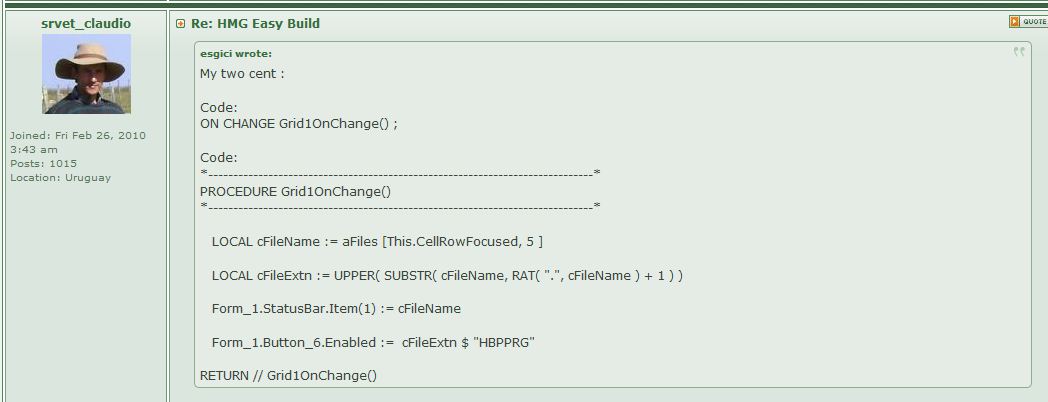

Dear Masters,
Is these working ok ?

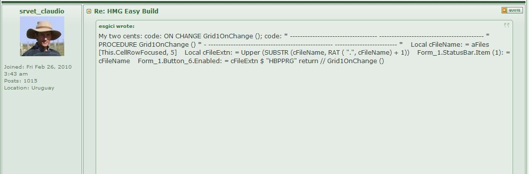

Thks for the info but...
i just want to report bugs... ( maybe not)
Before translation
Before translation
After translate to English ...
