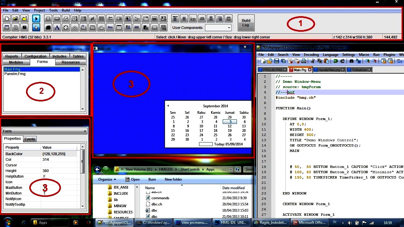

Screenshoot attached herein, is a sample screen handle we need to implement on our application, ASAP. Being programmers for long time, we need any advanced skill in order to satisfy our users/clients currently still using our DOS-apps-versions.
HMG-IDE is documented in HMG IDE section of HMG Doc and here.

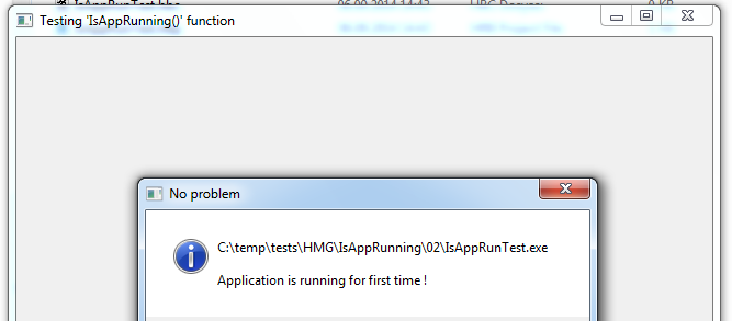

2) How to avoid one app/EXE is double-run by users in the same computer? This problem never arise under DOS who own a single window. I noticed when execercising HMG-ID (executing IDE.EXE) to build project, the RUN (F5) function fails to detect the problem. that's way HMG-IDE made runtime error as if the mistake came from source program.
Search "IsExeRunning" keyword in the forum. In addition, here a sample to check double-run condition (thanks to Dr. Soto for required functions ) :
PROCEDURE Main()
   DEFINE WINDOW frmIsAppRunTest ;
      ROW 0 ;
      COL 0 ;
      WIDTH 650 ;
      HEIGHT 450 ;
      TITLE "Testing 'IsAppRunning()' function" ;
      ON INIT DoTest() ;
      MAIN
   END WINDOW // frmIsAppRunTest
   frmIsAppRunTest.Center()
   frmIsAppRunTest.Activate()
RETURN // IsAppRunTest.Main()

Re: How To Help Clipper & Foxpro Users Catch Harbour-HMG ASA
Esgici wrote:...here a sample to check double-run condition (thanks to Dr. Soto for required functions )
Sample program slightly modified :
Application running for first time
Attempted to run application twice
IsAppRunTest.zip
Source file ( .prg, hbp ) for IsAppRunTest
(825 Bytes) Downloaded 651 times
