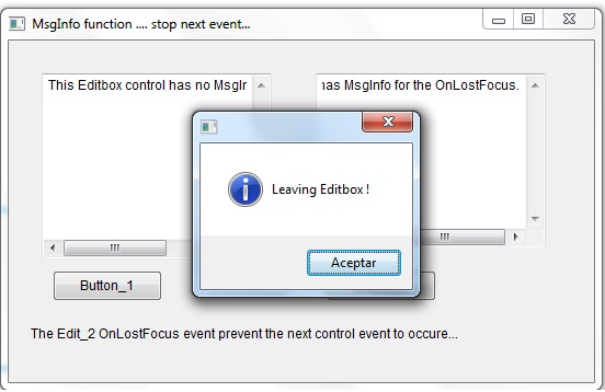

Re: MsgInfo stop next control event to run ?
Hola HMGChang,
A mi si me muestra bien los MsgInfo de EditBox2 y del Boton2 de tu muestra!
Te envio imagen de que si fuciona bien!, yo tuve ese error y no me quedo más que reinstalar HMG!, Sin antes de buscar virus!
Hello HMGChang,
My well if you show me MsgInfo EditBox2 and Key2 of your shows!
I send you picture if I had fuciona well !, that mistake and do not stay more than reinstall HMG before seeking !, No virus!
greetings
no error.jpg (45.2 KiB) Viewed 4583 times

The problem is not your code, the problem is in the behavior of the dialog box that in HMG returns the focus to the control that triggered.
