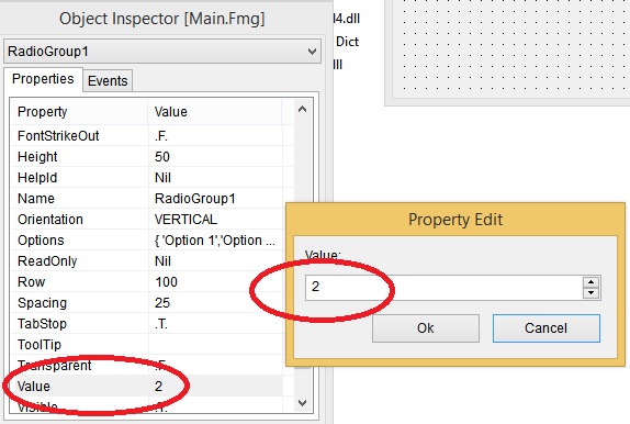

Setting value other than 1 in object inspector will trigger the OnChange event.
What I understand is value in object inspector is intialise value of object and OnChange event will not trigger.
The sample using value 2 and the main form title will change to "OnChange event occur 1 time(s)"

Hi Kek,
I was not understandig well what you are trying to tell us. But when I done some tests, I say the bug and I hope to be usefull to everyone what's goin on by based on following steps:
1. Open project, load fmg file and click on RadioGroup.
2. At Object Inspector window, you will see Value: 2
3. You can build app and will see RadioGroup starting at second item. Up to here is ok.
4. If you change value to 1 and rebuild, you will see the app starts still at second item, whi is wrong. I mean, did not changed to 1, still remain at second item.
Is it this you declared problem Kek ?
P.s. I have tested on 3.1.1, 3.3.1 and 3.0.46 HMG versions with same wrong behaviour.
I also re-edited manually the fmg file in ANSI and UNICODE modes on WINXP and with same wrong behaviour.

I'm doubting with initialise value in the object inspector and how the event is fired.
I thought setting value 1 or 2 in the object inspector will not fired the event.
To see the behaviour, we need to change the value from 2 to 1 (in object inspector) and recompile it.

Yes, I can confirm that is a bug in the IDE when initializes variable at RadioGroups. Even changing value thru IDE, this does not works properlly, not re-assign the internal variable into the IDE. But... if you change the value, then exit IDE confirm saving the fmg and run again the IDE and re-build... then you will see that works ok. But needs to exit IDE to re-load again for buildng. This is IDE bug.
Dear Claudio, please note this wrong behaviour at HMG IDE. I hope am been clear enough to understand it. In case not been understood, tell me I write in spanish again.
