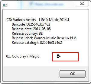

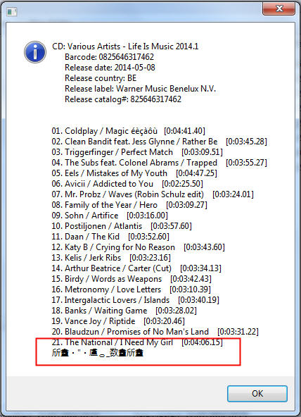

There is a problem with both codes, however
Mr. esgici's code does not read to the end of the file but stops somewhere :(
Dr. Claudio's code reads too much :) (see the "garbage" characters at the end of the file)
Not beautiful in Msgbox, but I can filter out in my code. ;)

Clip2Mania wrote:...
There isn't such truncate problem in my method and upper extra characters in Claudio's method at my side :(

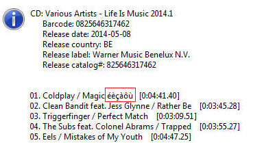

Mr esgici,
the trouble is in the accents/special characters (it always is :( )
I tried adding 'SET CODEPAGE TO UNICODE' at the beginning of the program, but that does not change anything.
Chanson_EAC.zip
(1.12 KiB) Downloaded 790 times

It is true, I added the éèçàôù characters in the file, because they are very common. In the example above,
if you leave them out, you will see that they are not correctly translated further in the file.
