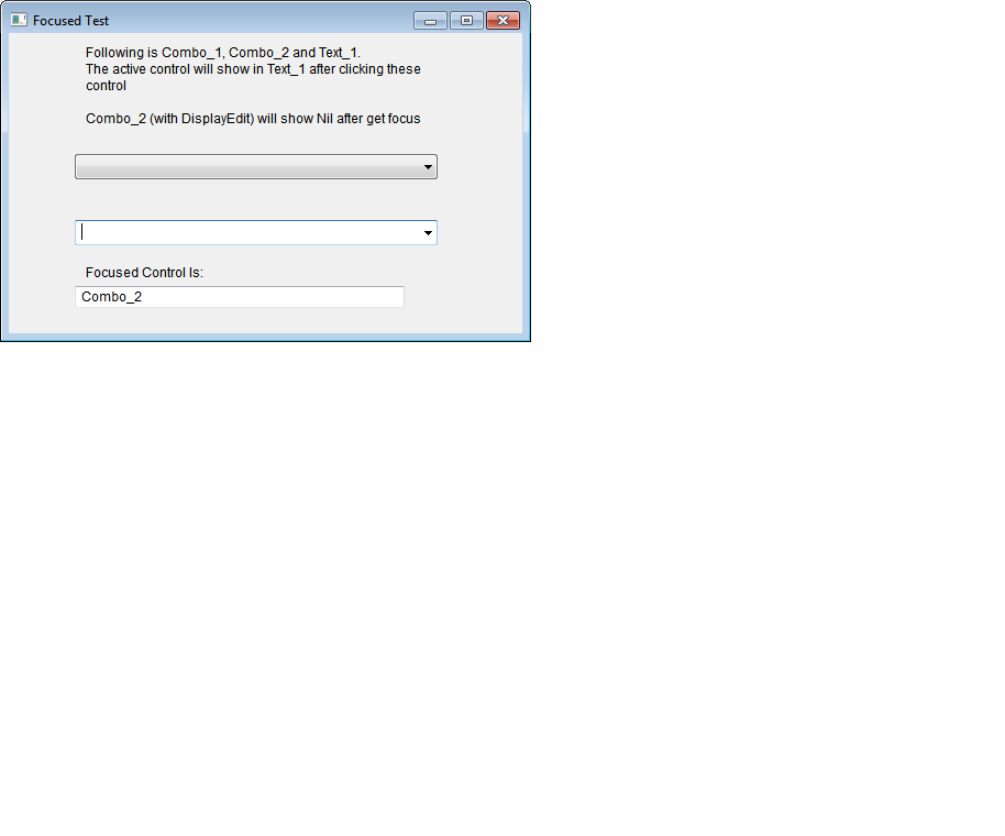

The FocusedControl Property return Nil if combo box has style of DisplayEdit

It was fixed already in HMG Extended Edition and will be available at a next build.
Corrected screenshot
