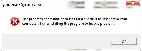

Dear Sirs,
i tried to compile the Harbour Contributions located at
HMG.3.2\HARBOUR\CONTRIB\HBTIP\TEST\GMail.hbp,
but get this :
Pls advice me what to do !
TIA
best rgds,
Chang
Just Hmg It !
How to compile the Harbour Contrib hbTip Test prg ?
hmgchang wrote:i tried to compile the Harbour Contributions located at
HMG.3.2\HARBOUR\CONTRIB\HBTIP\TEST\GMail.hbp, but get this :
Hi Chang,
This is pure Harbour demo, not HMG. Please, read this:
http://answers.microsoft.com/en-us/wind ... 9bbbd6a8de
Re: How to compile the Harbour Contrib hbTip Test prg ?
put libeay32.dll into sample directory and everything will go OK
Try download
OpenSSL Ligth from http://slproweb.com/products/Win32OpenSSL.html , install and compile gmail demo.
