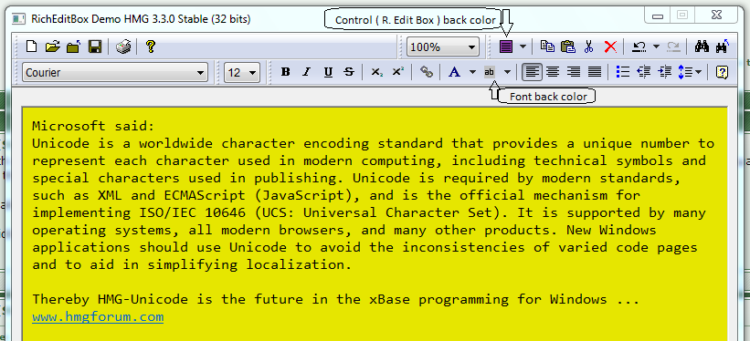

Hola Eduardo
- Change BG color in .rtf file.
- Save ( with different name if necessary )
- Open saved file
You will see BG color unchanged :(
I guess serge said this.
Bug in RichEditBox : backgroundcolor
EduardoLuis wrote:I don't understand why file was not attached.-
Probably an error was displayed saying this kind of file was not allow to attach. Please compact if in zip or rar file and make sure to attach file again.
Re: Bug in RichEditBox : backgroundcolor
esgici wrote:...
I'm afraid that I has been confused two thing : Control ( R. Edit box ) Back Color and Font Back Color.
Control BG not saved and font BG always saved successfully.
As far as I see Control BG not supported other standrad RTF editor WordPad.
Esgici,
You are right: these are two different things.
I was thinking that the backcolor (the yellow one) could be saved within the RTF format. This backcolor is only the backcolor of the Richeditbox.
Only the FontBackColor is RTF and this is saved correctly!
So, everything is OK!
Greetings, Serge
