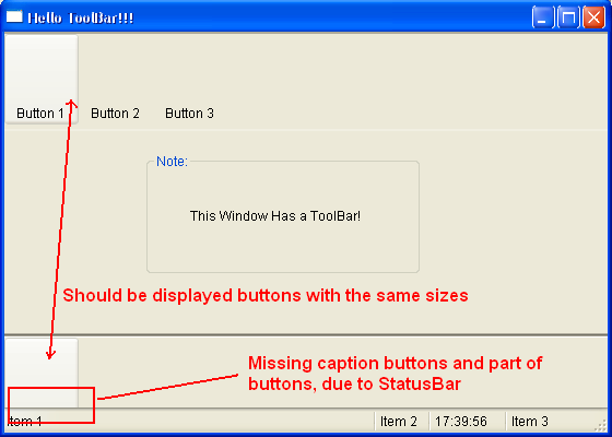

When is necessary to make two ToolBars (manually, because via IDE is not possible) one Top another Bottom and you increase a StatusBar: all ToolButtons (Bottom ones) are not displayed in the right size. In order words, the ToolBar Bottom is not calculating to be displayed upper than StatusBar. So, seems Statusbar is taking place part of ToolButtons (bottom) and can not be completly displayed.
This is a fmg file example:

Please note captured screen:

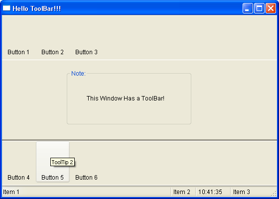

Windows always overlaps the StatusBar and the Bottom ToolBar.
The trick is: when Windows begin to draw the Bottom ToolBar first I move it to up.

Thank you Claudio, now is working perfectly, even if you amke StatusBar after sequence of ToolButtons.
