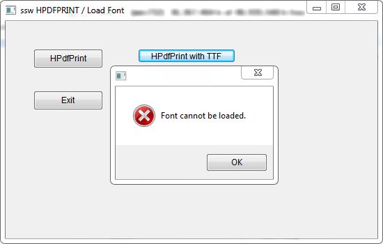

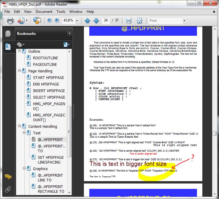

Dear Masters & Friends,
i try to load the ttf font :
[img]d:\test\tscparan_TTF.JPG[/img]
but i get this :
[img]fontcannotbeloaded.JPG[/img]
What am i doing wrong ?
Pls help !
Thks n rgds
Chang :)

this is what i get : error !
Just Hmg It !
HPDFPRINT with Font cannot be loaded
It is something quite difficult to guess what is happen without your code ! :mrgreen:
Probably your font file isn't in current folder. Try to put the FULL path.

Re: HPDFPRINT with Font cannot be loaded
There is a fix in the next version of HMG. I am sure it will solve this problem.
For the time being, try to give the full path of the font file.
Rathinagiri wrote:For the time being, try to give the full path of the font file.
Yeah, as I have already told him...
Only in the new version is going to find the ttf file. Is necessary to know where the file is. If is not in current folder, will not find. And I think even been in current, will need the fullpath of ttf file.
