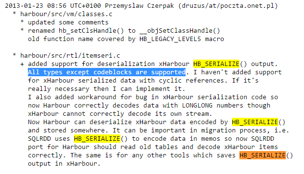

In this topic I am approaching about CodeBock convertion to String in Harbour.
This trying convertion seems it is failed at Harbour... :? This procedure is called by HB_Serialize() which it would convert to binary string but except to CodeBlocks... :(
See Harbour ChangeLog from Przemyslaw Czerpak at 2013-01-23
I found this [x]Harbour reference documentation: http://www.creasolgroup.com/xOraclipLan ... _f.en.html

Transform CodeBlocks in strings
Posted: Sat Oct 15, 2016 5:48 pm
Pablo César wrote:My next attempt will be use of _PP functions...
Not worked too... :(
I found this text (In xhb-diff.txt)
### CODEBLOCK SERIALIZATION / DESERIALIZATION ###
xHarbour has support for codeblock serialization. It's done by simple
storing compiled codeblock body (PCODE) in string variable and then
restoring it from such variable. Harbour does not support it intentionally
and in such form it will never be supported by HVM because it can work
only in some very limited situations and then can be source of very bad
bugs like internal HVM memory corruption or absolutely unexpected runtime
behaviors. Compiled PCODE contains references to symbol tables or even
memory addresses (i.e. macrocompiled codeblocks). If application stores
such codeblock in some external holder, i.e. memo file then after restoring
by different instance of the same application memory addresses can be
different so for macrocompiled codeblocks it's not safe at all. For
codeblocks compiled by compiler it can work until exactly the same
application is used. But any modifications in the code can change
symbol table so after restoring the result can be unpredictable.
Codeblock like:
{|x| qout( x ) }
can be defined in code where just after QOUT() in symbol table is FERASE().
Small modification in application code can cause that symbols will be
moved and above codeblock after restoring will effectively execute FERASE()
instead of QOUT(). What does it mean for programs which makes something like:
eval( cb, "The most import file is:" )
eval( cb, cDataFile )
eval( cb, "Please make backup." )
I do not have to explain.
With full respect to xHarbour users IMO such "extension" is giving knife
into monkey hands.
Codeblock serialization can be implemented in safe way but it needs at
least some partial PCODE (de|re)compiler. If Harbour users find codeblock
serialization as important extension then maybe we create such PCODE
recompiler and such functionality will be added. Anyhow it will be necessary
to keep recompiler code synced with compiler and it will be additional job
in any future compiler modifications which can change generated PCODE.
There is another person who has looked up for the same propose: just to take Block data as strings not to execute it.
I believe would it exist this conversion just for displaying not for executing proposes... :?
