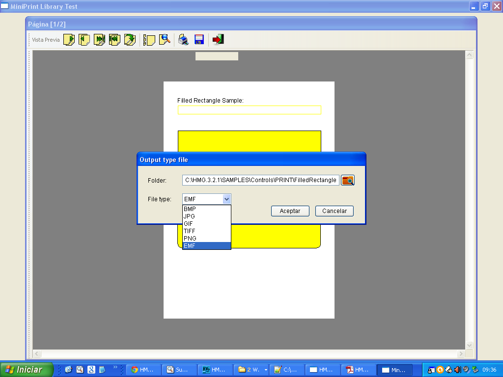

When the command print preview, it display toolbar for Save
instead of printing... but it only save to .emf ?
How about to other format or PDF ?
Pls help me...
Thks n Rgds
Chang
Just Hmg It !
PRINT DATA With Macro Substitution
hmgchang wrote:When the command print preview, it display toolbar for Save
ToolBars in HMG_PREVIEW it for your own options. User decides if wants to print or just PREVIEW.
In the next HMG release, we can count with others options to convert metafiles to other image format like: "BMP","JPG","GIF","TIFF","PNG".
For this option, we can count with HMGHPDF it is so simple and very good library. See also an example at C:\HMG.3.2\hfcl\Samples\HMGHPDF\demo.Prg
Pls help me...
Helping in what ? Many question: many responses... you need to study deep into HMG sources. All it is in your own computer when HMG is installed. I suggest to see all HMG examples in SAMPLES folder and you will learn a lot with it.
