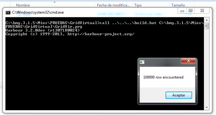

Re: Bug in virtual grid / strange behaviour
Jpp I compile your example and not encounter any discomfort, if indeed increases with time DinamicBackColor 1,000,000 items, but do not consider it a long time, if it increases 5 times the load time, but I consider normal as eg once did a similar small town in Excel and fail to 1,000,000 rows and increasing formats and formulas, if that was really slow! It's just a comparison. and a database of 100 fields have not seen one!
try to add this phrase in QueryTest function:
if this.queryrowindex = 100000
  MsgBox('100000 row encountered')
Hi Mol,
mol wrote:try to add this phrase in QueryTest function:
Code:
Successful or unsuccessful?
I integrate the function and if it works well.
Procedure QueryTest()
	count++
	This.QueryData := Str ( This.QueryRowIndex ) + ',' + Str ( This.QueryColIndex )
This message should appear after scrolling to 100000 row. Not at the initiation of the grid. Virtual grid shouldn't touch 100000' row till the time when this row should be presented on the screen.
