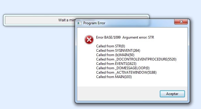

Andy,
Nice, but it gives an error, so I didn't see it in action!
Date:17/02/2014 Time: 23:29:49
Error BASE/1099 Argument error: STR
Greetings, Serge

Hi Serge
* No tengo ningun texto que diga "Date:" or "Time:" pudieras mandarme el mensaje de error completo ?
* Aclaro que yo tengo Win XP SP3, no lo he probado en Win7 u Win8
* Aclaro tambien que me estoy basando en el ejemplo puesto por Maximiliano, no tengo mucho conocimiento
como manejar la información con WMI ( Windows Management Instrumentation )
* Según Microsoft, algunas propiedades pueden estar ó no estar en diferentes Sistemas Operativos.
* Alguien mas tiene un problema similar ?
Hi Serge
* I do not have any text that says "Date:" or "Time:" could send me the full error message?
* I must say that I have Win XP SP3, I have not tried in Win7 or Win8
* Let me clarify that I'm also basing on the example set by Maximiliano, I have little knowledge
manage information as WMI (Windows Management Instrumentation)
* According to Microsoft, some properties may be or not be in different OSes.
* Anyone else have a similar problem?

andyglezl wrote:...
Yes !
When clicked Hardware Inventory :
Date:18/02/2014 Time: 02:06:01
Called from STR(0)
Called from SYSINVENT(264)
Called from (b)MAIN(50)
Called from _DOCONTROLEVENTPROCEDURE(5520)
Called from EVENTS(1623)
Called from _DOMESSAGELOOP(0)
Called from _ACTIVATEWINDOW(5188)
Called from MAIN(103)
Added later :
Win7 32 bit

Serge and Esgici, which OS do you use and is 32 or 64 ?

Hola,
El error! Win 7, 32
