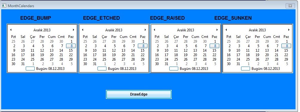

The Win32 API features a new function called DrawEdge. Its purpose is to draw 3D effects for all Windows applications. And this function was missing in HMG and Minigui.
The DrawEdge function is a useful function provided by the Win32 API. It can draw a variety of the edge styles used to draw buttons, frames and borders around controls and forms.
I made a Demo to show how each controls can be draw it. Not all components looks like pretty, but can be used as you wish.
I added a GetControlCoords which returns the coordinates for one specific control (position/size). There is also a 3rd parameter which programmer can use just to adjust for fit around the control in pixels. IMO this function would it beadd to HMG library at h_controlmisc.prg, so that everyone can use with some certain frequency.
If anyone has any suggestions or has made some improvement, please excite in to say/describe so we can improve the code.
I hope this resource is useful and you enjoyed.

hbmk2: Compiling Harbour sources...Pablo César wrote:The Win32 API features a new function called DrawEdge. Its purpose is to draw 3D effects for all Windows applications. And this function was missing in HMG and Minigui.
Harbour 3.2.0dev (Rev. 18911)
Copyright (c) 1999-2013, http: // harbour - project . org
C:\test\DrawEdge\main.prg(43) Error E0030 Syntax error "syntax error at '.'"
C:\test\DrawEdge\main.prg(160) Error E0030 Syntax error "syntax error at '.'"
44 errors
No code generated.

hbmk2: Compiling Harbour sources... Harbour 3.2.0dev (Rev. 18911) Copyright (c) 1999-2013, http://harbour-project.org" onclick="window.open(this.href);return false;" onclick="window.open(this.href);return false;" onclick="window.open(this.href);return false;" onclick="window.open(this.href);return false;" onclick="window.open(this.href);return false; C:\test\DrawEdge\main.prg(43) Error E0030 Syntax error "syntax error at '.'" C:\test\DrawEdge\main.prg(44) Error E0030 Syntax error "syntax error at '.'" C:\test\DrawEdge\main.prg(45) Error E0030 Syntax error "syntax error at '.'" C:\test\DrawEdge\main.prg(46) Error E0030 Syntax error "syntax error at '.'" C:\test\DrawEdge\main.prg(56) Error E0030 Syntax error "syntax error at '.'" C:\test\DrawEdge\main.prg(57) Error E0030 Syntax error "syntax error at '.'" C:\test\DrawEdge\main.prg(58) Error E0030 Syntax error "syntax error at '.'" C:\test\DrawEdge\main.prg(59) Error E0030 Syntax error "syntax error at '.'" C:\test\DrawEdge\main.prg(69) Error E0030 Syntax error "syntax error at '.'" C:\test\DrawEdge\main.prg(70) Error E0030 Syntax error "syntax error at '.'" C:\test\DrawEdge\main.prg(71) Error E0030 Syntax error "syntax error at '.'" C:\test\DrawEdge\main.prg(72) Error E0030 Syntax error "syntax error at '.'" C:\test\DrawEdge\main.prg(82) Error E0030 Syntax error "syntax error at '.'" C:\test\DrawEdge\main.prg(83) Error E0030 Syntax error "syntax error at '.'" C:\test\DrawEdge\main.prg(84) Error E0030 Syntax error "syntax error at '.'" C:\test\DrawEdge\main.prg(85) Error E0030 Syntax error "syntax error at '.'" C:\test\DrawEdge\main.prg(95) Error E0030 Syntax error "syntax error at '.'" C:\test\DrawEdge\main.prg(96) Error E0030 Syntax error "syntax error at '.'" C:\test\DrawEdge\main.prg(97) Error E0030 Syntax error "syntax error at '.'" C:\test\DrawEdge\main.prg(98) Error E0030 Syntax error "syntax error at '.'" C:\test\DrawEdge\main.prg(108) Error E0030 Syntax error "syntax error at '.'" C:\test\DrawEdge\main.prg(109) Error E0030 Syntax error "syntax error at '.'" C:\test\DrawEdge\main.prg(110) Error E0030 Syntax error "syntax error at '.'" C:\test\DrawEdge\main.prg(111) Error E0030 Syntax error "syntax error at '.'" C:\test\DrawEdge\main.prg(129) Error E0030 Syntax error "syntax error at '.'" C:\test\DrawEdge\main.prg(130) Error E0030 Syntax error "syntax error at '.'" C:\test\DrawEdge\main.prg(131) Error E0030 Syntax error "syntax error at '.'" C:\test\DrawEdge\main.prg(132) Error E0030 Syntax error "syntax error at '.'" C:\test\DrawEdge\main.prg(134) Error E0030 Syntax error "syntax error at '.'" C:\test\DrawEdge\main.prg(135) Error E0030 Syntax error "syntax error at '.'" C:\test\DrawEdge\main.prg(136) Error E0030 Syntax error "syntax error at '.'" C:\test\DrawEdge\main.prg(137) Error E0030 Syntax error "syntax error at '.'" C:\test\DrawEdge\main.prg(139) Error E0030 Syntax error "syntax error at '.'" C:\test\DrawEdge\main.prg(140) Error E0030 Syntax error "syntax error at '.'" C:\test\DrawEdge\main.prg(141) Error E0030 Syntax error "syntax error at '.'" C:\test\DrawEdge\main.prg(142) Error E0030 Syntax error "syntax error at '.'" C:\test\DrawEdge\main.prg(144) Error E0030 Syntax error "syntax error at '.'" C:\test\DrawEdge\main.prg(145) Error E0030 Syntax error "syntax error at '.'" C:\test\DrawEdge\main.prg(146) Error E0030 Syntax error "syntax error at '.'" C:\test\DrawEdge\main.prg(147) Error E0030 Syntax error "syntax error at '.'" C:\test\DrawEdge\main.prg(157) Error E0030 Syntax error "syntax error at '.'" C:\test\DrawEdge\main.prg(158) Error E0030 Syntax error "syntax error at '.'" C:\test\DrawEdge\main.prg(159) Error E0030 Syntax error "syntax error at '.'" C:\test\DrawEdge\main.prg(160) Error E0030 Syntax error "syntax error at '.'" 44 errors No code generated.
Form.HANDLE
It is the same that: GetFormHandle ( cForm )
This example was compilated with 3.1.5 UNICODE (with patches applied).
Source code was optimized a bit. Please replace Form.HANDLE with GetFormHandle ( cForm ) in case is persisting errors in your HMG and recompile it.

Esgici, please noteesgici wrote:Harbour 3.2.0dev (Rev. 18911)Pablo César wrote:Optimized code and added a FRAMEs options too (not so nice) but can gives an idea to replace frames for DrawEdge.
Copyright (c) 1999-2013, http://harbour-project.org/" onclick="window.open(this.href);return false;" onclick="window.open(this.href);return false;" onclick="window.open(this.href);return false;" onclick="window.open(this.href);return false;
C:\test\DrawEdge\DrawEdge2\main.prg(43) Error E0030 Syntax error "syntax error at '.'"
C:\test\DrawEdge\DrawEdge2\main.prg(58) Error E0030 Syntax error "syntax error at '.'"
C:\test\DrawEdge\DrawEdge2\main.prg(73) Error E0030 Syntax error "syntax error at '.'"
C:\test\DrawEdge\DrawEdge2\main.prg(88) Error E0030 Syntax error "syntax error at '.'"
C:\test\DrawEdge\DrawEdge2\main.prg(103) Error E0030 Syntax error "syntax error at '.'"
C:\test\DrawEdge\DrawEdge2\main.prg(118) Error E0030 Syntax error "syntax error at '.'"
C:\test\DrawEdge\DrawEdge2\main.prg(182) Error E0030 Syntax error "syntax error at '.'"
7 errors
No code generated.
Because I have NO problems with this compilation here. Which version are you using ? More details please.Pablo César wrote:It is the same that: GetFormHandle ( cForm )

MonthCalendar are displayed in different sizes in XP and Win7. And Width and Height can not manipulate without cutting off part from both. So by this reason is good to use IsXp() to differenciate size/positions. Note in following lines:
Setproperty("Screen_1","Width",GetProperty("Screen_1","Width")+(If(_HMG_SYSDATA [ 250 ],0,100)))
_HMG_SYSDATA [ 250 ] is logical value as true when is in XP.
