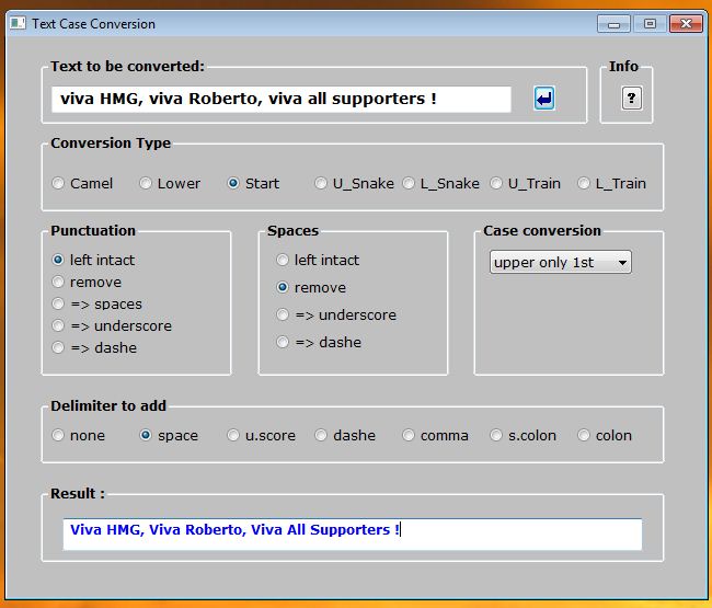

Pablo César wrote:I have looking for this important (at least for me) all around Harbour, Minigui and also HMG but not found anything about this.
Probably will be usefull for many programmers and also important to implement in IDE which is having strange behaviour (click here for more details) about lower modules names.
This Demo brings the function CamelCase which have different options,...
I hope you enjoy and be usefull. :)
Thank to share :)
This is important and interesting subject to me also.
So I want to participate, hopefully no problem will occurs :arrow:
Everything is for community and we haven't any aim other than to search the better.
Screen sohot of Text Case Converter
TextCaseConvSrc.zip
Source files of Text Case Converter
(216.4 KiB) Downloaded 345 times
TextCaseConvExe.zip
Executable of Text Case Converter
(1.21 MiB) Downloaded 320 times
