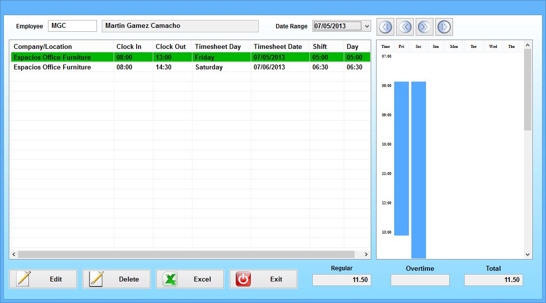

Estoy tratando de generar una grafica usando un grid para lograr lo que me piden, hay alguna manera de hacer que las lineas del frid, reduzcan su ancho para lograr que ajustar a la ventana, es decir sin usar los scrolls

is a time chart, so the most accurate way to show it on in 4 lines per hour , in periods of 15 minutes
Esgici,It is on a grid that I need to form in the same line up to three entries per day, and the grid was adjusted to my needs, only now the user wants to see everything in the window without the scrolls

There are not pictures, coloring the cells of the grid individually
Try to find a chart, but none meets the requiements of the end user, the only thing stopping me is that I can not change the width of the rows of the grid.
I'm trying right now with RMChart

martingz wrote:There are not pictures, coloring the cells of the grid individually...
Good idea :arrow:
May be a character string colored with length on base value in a single cell ? ( as a horizontal bar for each line in the left GRID )
FE: REPLICATE( CHR( 255 ), <nBaseValue> / <nIncrement> )
Anyway, the opinion of Pablo is good and applicable, I think.
Because in graphics, the goal is to demonstrate numeric values as picture / shape for build a visual comparison; neat accuracy may not be very important in many cases.

Unfortunately the end user wants with 4 lines per hour, so that visually it easier
I think Pablo is right
Was my first elecion, 2 lines per hour, but did not accept
Good idea , gave me a good point, try to make it with two different characters one at half and full otherwise, so will use nothing but 2 lines per hour
Thank you very much
