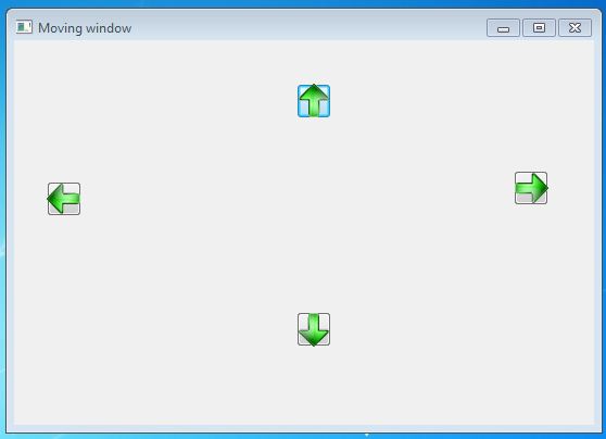

So the code I posted could be improved like this:
#define HTCAPTION 2
#define WM_MOVE 3
#define WM_NCLBUTTONDOWN 161
DEFINE WINDOW Form_1 ;
WIDTH 400 ;
HEIGHT 200 ;
TITLE 'Hello World!' ;
MAIN ;
ON MOUSECLICK MoveActiveWindow()
DEFINE STATUSBAR
STATUSITEM "Click on Form and holding mouse's button for moving this window"
END STATUSBAR
DEFINE LABEL Label_1
ROW 100
COL 10
VALUE ""
END LABEL
// Form_1.Cursor := "hand32-32.cur"
Form_1.Cursor := "Move-32.cur"
CENTER WINDOW Form_1
CREATE EVENT PROCNAME MoveTest() HWND Form_1.HANDLE MSG WM_MOVE
ACTIVATE WINDOW Form_1
Function MoveActiveWindow( hWnd )
DEFAULT hWnd := GetActiveWindow()
PostMessage( hWnd, WM_NCLBUTTONDOWN, HTCAPTION, 0 )
// FileCursor( "Grabbed32-32.cur" )
FileCursor( "Maggy.ani" )
Function MoveTest()
Local xPos := LOWORD(EventlParam())
Local yPos := HIWORD(EventlParam())
Form_1.Label_1.Value:="Lin: "+Str(yPos,3,0)+" / Col: "+Str(xPos,3,0)
#pragma BEGINDUMP
#include <windows.h>
HB_FUNC( FILECURSOR )
hb_retnl( ( LONG ) SetCursor( LoadCursorFromFile( hb_parc( 1 ) ) ) );
#pragma ENDDUMPHMGing a better world
ON MOUSEDRAG ?
Hereunder is some cursor pointers, one is animated cursor pointer.
I hope you enjoy ! (Sorry I couldn't resist it...)

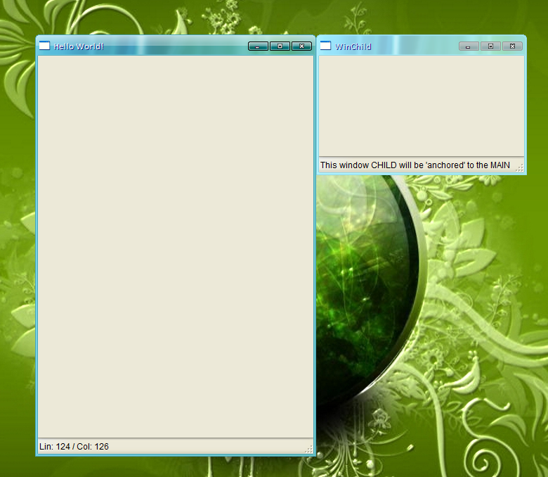

Re: ON MOUSEDRAG ?
Gracias Pablo César, esgici y Claudio
Revisé los ejemplos que enviaron e hice esto.
La idea que traigo es crear 2 ventanas, y que al mover la ventana 'Main',
la ventana 'Child' se acople a un lado de la 'Main'.
El siguiente código ya lo hace, hay que mover la ventana MAIN y darle click,
la ventana CHILD se ubicara a un lado de la MAIN. Lo que quiero es que
automaticamente la ventana CHILD se "acople" al deja de pulsar el botón del
ratón.
Thanks Pablo Cesar, Esgici and Claudio
I checked the examples sent and made this.
The idea is to create 2 windows bring, and that moving the window 'Main'
window 'Child' engages a side of the 'Main'.
The following code already does, you have to move the MAIN window and give click,
CHILD window was located on one side of the MAIN. What I want is that
CHILD window is automatically "attach" to stop pressing the button
mouse.
ratón.
mouse.
#define HTCAPTION 2
#define WM_MOVE 3
DEFINE WINDOW Form_1 AT 0,0 WIDTH 400 HEIGHT 600 TITLE 'Hello World!' MAIN ;
ON MOUSECLICK MoveActiveWindow() ;
ON INIT ( CreaChild( GetFormHandle('Form_1') ), MoveActiveWindow( hWnd ) )
DEFINE STATUSBAR
END STATUSBAR
FUNCTION CreaChild()
Local xPos := Form_1.Row
Local yPos := Form_1.Col
Local nWidth := Form_1.Width
DEFINE WINDOW Form_2 AT xPos,yPos+nWidth WIDTH 300 HEIGHT 200 TITLE 'WinChild' CHILD
DEFINE STATUSBAR
STATUSITEM "This window CHILD will be 'anchored' to the MAIN ..."
END STATUSBAR
ACTIVATE WINDOW Form_2
RETURN Nil
Form_1.StatusBar.Item(1):="Lin: "+Str(yPos,3,0)+" / Col: "+Str(xPos,3,0)
Form_2.Row:=xPos
Form_2.Col:=yPos+nWidth
