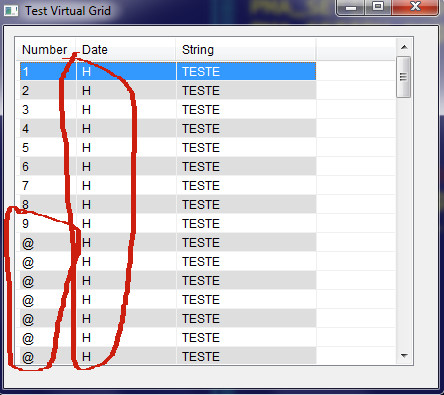

Please, anyone know the reason for this behavior on the grid?
* TEST VIRTUAL GRID
FUNCTION Main()
PRIVATE aMyData  := {}
PRIVATE bColor := { || IIF( This.CellRowIndex / 2 == INT( This.CellRowIndex / 2 ) , { 222,222,222 } , { 255,255,255 } ) }
DEFINE WINDOW Win_Grid ;
		WIDTH 450 ;
		HEIGHT 400 ;
		TITLE "Test Virtual Grid" ;
		MAIN
  DEFINE GRID My_Grid
    ROW 10
    COL 10
    WIDTH 400
    HEIGHT 330
    HEADERS { "Number", "Date", "String" }
    WIDTHS { 60, 100, 140 }
    DYNAMICBACKCOLOR { bColor , bColor , bColor }
    ITEMS aMyData
    ITEMCOUNT LEN( aMyData )
    * Parameters for Virtual Grid
    VIRTUAL .T.
    ONQUERYDATA Grid_Query()
  END GRID
* Prepare Mounting Grid
Create_Data()
CENTER WINDOW Win_Grid
ACTIVATE WINDOW Win_Grid
STATIC FUNCTION Create_Data()
LOCAL x
aMyData := {}
FOR x = 1 TO 100
  AADD( aMyData, { x, DATE() - x, "TESTE" } )
NEXT x
* Entering Data on the Grid
DECLARE WINDOW Win_Grid
Win_Grid.My_Grid.DeleteAllItems
IF LEN( aMyData ) > 0
  * Sets the current position of the item in the grid
  Win_Grid.My_Grid.ItemCount := LEN( aMyData )
  Win_Grid.My_Grid.Value     := 1
  Win_Grid.My_Grid.Refresh
  Win_Grid.My_Grid.SetFocus
FUNCTION Grid_Query()
LOCAL nRow_   := This.QueryRowIndex
LOCAL nCol_   := This.QueryColIndex
This.QueryData := Convert2Sstring( aMyData[ nRow_, nCol_ ] )
FUNCTION Convert2Sstring( xData_ )
* converting to string
LOCAL xReturn_ := ""
* Character
IF VALTYPE( xData_ ) = "C"
  xReturn_ := xData_
* Numerical
ELSEIF VALTYPE( xData_ ) == "N"
  xReturn_ := LTRIM( STR( xData_ ) )
* Date
ELSEIF VALTYPE( xData_ ) == "D"
  xReturn_ := DTOC( xData_ )
* The data can not be converted
  xReturn_ := ""
RETURN xReturn_
See the picture

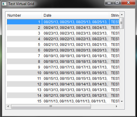

andyglezl, Thanks for answering.
But when I use queryData I'm sending data strings for the grid, I urge is that I do not understand.
If you change the routine of converting data to string columns appear normal, ie, does not seem to be the reason that you mentioned.
see example changed
* Character
  xReturn_ := xData_
* Numerical
  xReturn_ := str( xData_, 35 )       //  LTRIM( STR( xData_ ) )
* Date
  xReturn_ := REPLICATE( DTOC( xData_ ) + ", ", 4 )      // DTOC( xData_ )
  xReturn_ := ""
RETURN xReturn_

The problem is that I can not display a simple CTOD () or str ().
It seems to be related to the size of the column, but I still can not find the reason. :( :roll:
