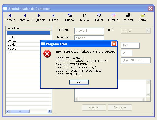

Hello,
file: "c; \ SAMPLE \ SAMPLESAPPLICATION"
in HMG Version 3.1.5, when using the window "of ADMINISTRADOR CONTACTOS" the following error occurs.
While it works well in HMG.3.1.4
Thank you to take a look.
good result
good result

Re: HMG.3.1.5 "Sample \ SampleApplication \ Contactos"
I have verified, it is working fine in 3.1.5 version
Have you applied patch ?
viewtopic.php?f=43&t=3092&start=60
Thank Dave
Confirmed, you need apply that patch.
By the way, ( as commented in my sign ) please feel free to communicate with me directly [ esgici <at> gmail <dot> com ] whenever you need. I'm not one of who closed communication ways to friends
Happy HMG'ing
Thank you for your answers my friends
I changed the installation directory HMG.3.1.5 to HMG as I did for HMG.3.1.4.
I am going to reinstall the 3.1.5
thank you to you all
I tried to install it but I get errors that appear .Can you explain to me how to use these patchs please
thank's
THANK YOU VERY MUCHesgici wrote:Thank Dave
Hi Tabet,bpd2000 wrote:I have verified, it is working fine in 3.1.5 version
Happy HMG'ing
IT's OK
I didn't undestrand this sentence " re-build library and test demos.
thanks to you, everyday I learn something, even English
Merci Beaucoup
Merci Beaucoup
After patch installation, you have to execute file "c:\hmg.1.5.5\BuildLib.bat" to re-build librarytonton2 wrote:IT's OK![]()
thanks to you, everyday I learn something, even English![]()
Merci Beaucoup
After completion you can compile your progrm
Thank you It is OK !
