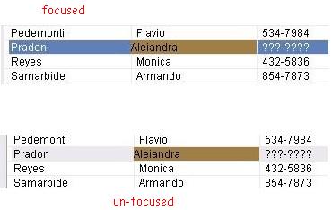

ExcellentRoberto Lopez wrote:Harbour MiniGUI 2.8.0 Changelog:
- Modified: GRID control. Navigation is 'by cell' from this version.
Depending on "focus" status of form, selected row color is changing; is this normal behavior ?
BTW, there isn't any news about "focus" status of forms at startup ?

Re: Harbour MiniGUI 2.8.0
Without an image, I'm not absolutely sure about the situation you describe, but normally, ListView selected row color changes when its parent window do not has the focus.esgici wrote: Depending on "focus" status of form, selected row color is changing; is this normal behavior ?
I've not read the thread. Is this a bug?esgici wrote: BTW, there isn't any news about "focus" status of forms at startup ?
Roberto.
Sorry. I've not seen the attachment.Roberto Lopez wrote:esgici wrote: Depending on "focus" status of form, selected row color is changing; is this normal behavior ?
Could you be so kind to send me the sample and the exact sequence to reproduce it ?
Roberto.
- Roberto Lopez
- HMG Founder
- Posts: 4023
I've verified as a bug.esgici wrote: BTW, there isn't any news about "focus" status of forms at startup ?
I'll publish a fix ASAP.
Roberto.
Hello Roberto
- Run program and click any row : focused status.
- Click anywhere out of main form ( without minimized ) : unfocused status.
That's all.
With best regards
Sample is MiniAgenda and sequence is :Roberto Lopez wrote: Could you be so kind to send me the sample and the exact sequence to reproduce it ?
That's all.
With best regards
Viva INTERNATIONAL HMG
- Roberto Lopez
- HMG Founder
- Posts: 4023
Its Ok.esgici wrote: Sample is MiniAgenda and sequence is :
The selected row color in ListVoew changes when its parent window losses the focus. It was always its behavior.
My work was make the 'cursor'. It is a child window placed over the currently highlighted ListView row at a selected cell.
Perhaps, I should consider to change the cursor color when listview parent window losses the focus for future versions.
Roberto.
