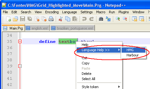

We can add a HMG.chm and also Harbour.chm options of help accessing by ContextMenu of Notepad++, as shows image below:
First at all we have to unpack these files (are not updated, whom have more actualized, please let us know) into a xBase folder on your hard disk.
xBase.rar
(506.41 KiB) Downloaded 2297 times
Second, check up yours plugins installation of your Notepad++ going by Plugins menu/Plugin Manager/Show Plupgin Manager/Installed tab if "Language Help" is already installed, in case not: go to "Availabe" tab and then install it.
Third, you will need to add chm files and setting up "Language Help" plugin, going to:
Fourth, you will need to add it as follows:
And setup it as follows:
Fifth, close and restart you Notepad++ and then you be able to use it, clicking with right mouse button on the any HMG or Harbour command and you can choose HMG or Harbour to see sintaxe with already word passed as argument for chm file (see first image of this message) and the result will be the followng one:
