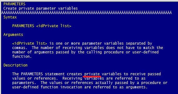

These variables declared PARAMETERS must be recognized as public by other procedures in the module, as documented in Clipper NG, but are not.
Sorry, but it seems that you are wrong; please look at attached image captured from Clipper NG.
What kind will be variable declared by PARAMETER statement ?
My fault, where I wrote public read private
Re: HMG 3.1.5. Variable Problem
Amarante wrote:My fault, where I wrote public read private
