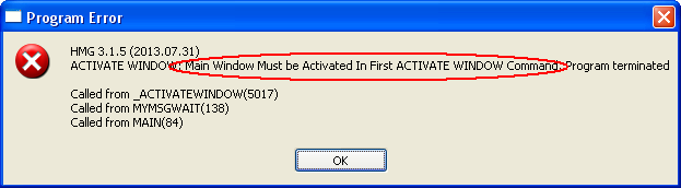

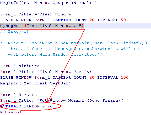

But it did not work where I wanted it to work (before activation of the Main window).
This happend because this:
As we know, the MessageBox function C does not depend on it, and for this reason I come to ask (perhaps the person who always contributed his expertise in C) the creation of a new function that allows do the autorelease through some timer. But it must be done in C. :|
This function I'm wanting is to be used in this example and also will be usefull for other cases as well.
