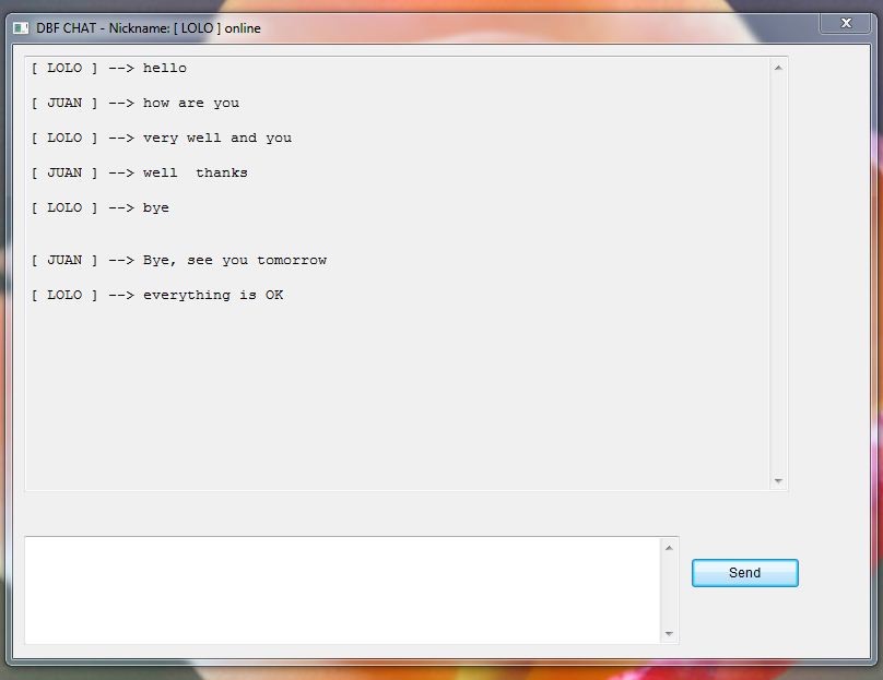

This is an example of a chat with DBF.
Open multiple copies of the program and register with differents nicknames.

srvet_claudio wrote: This is an example of a chat with DBF.
Nice, thanks Doc :)
DBF Chat Screen Shoot
DBF Chat Screen Shoot.JPG (47.58 KiB) Viewed 10348 times
Nice, thanks Doc :)
Thanks Friend.
