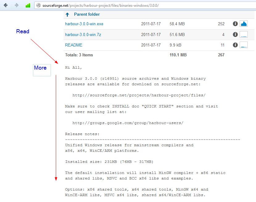

Try with MinGW 64 bits http://mingw-w64.sourceforge.net/
compile y Build Libs with MinGW 64, for it please read the text that accompanies Harbour 3.x
http://sourceforge.net/projects/harbour ... ows/3.0.0/
Harbour - Browse binaries-windows3.0.0 at SourceForge.png (34.48 KiB) Viewed 31818 times
You can also subscribe to Harbour User Harbour there looking like 64-bit compile from source, compile there from HMG 64 and thus have its full 64-bit application.
