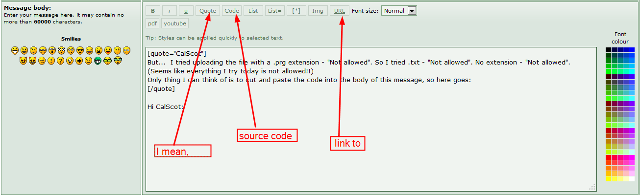

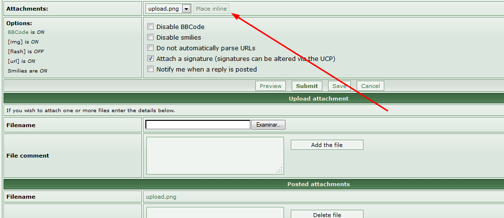

Re: Display an inactive checkbox group?
Posted: Thu Mar 21, 2013 11:30 pm
CalScot wrote: But... I tried uploading the file with a .prg extension - "Not allowed". So I tried .txt - "Not allowed". No extension - "Not allowed". (Seems like everything I try today is not allowed!!)
Only thing I can think of is to cut and paste the code into the body of this message, so here goes:
Hi CalScot:
You can compress files with WinRAR necessary and then add the new topic.
when you upload the new options will have to paste the content in the desired location within the edition.
after taking into editing mode that topic or reply
I mean, source code, link to.
