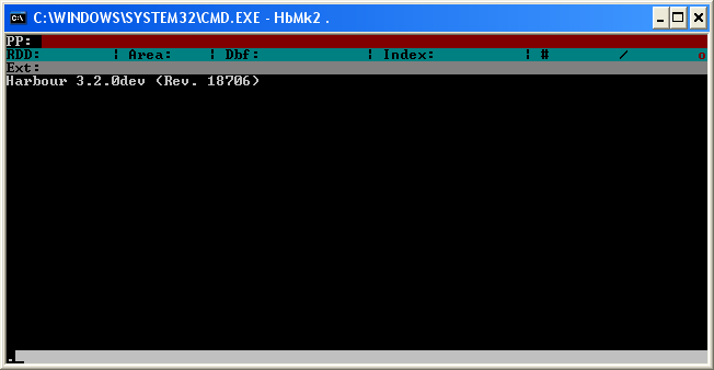

Have anyone seen HbMk2 as utility in Harbour (of course) using like as the old dBase III plus ??
So recently in another forum was presented HbMk2 for this propose by Mr. Alexandre ( alxsts ).
At Prompt Command (DOS screen, let say) you only need to type:
HbMk2 . (with space and one point)
Then it will display a screen like this:
Well the rest of commands, you should know !!!
You can type:
USE CLIENTS
BROWSE()
This is a good information, whom still misses the old dBase...

Re: HbMk2 using like as dBase in dot commad
Hola Pablo
Pablo César wrote:Have anyone seen HbMk2 as utility in Harbour (of course) using like as the old dBase III plus ??
Is this different to hbrun :?:
HbMk2 at prompt command
ohhh seems same. I did not know it, yet. I also saw in your website with many other examples. Thanks Esgici for clarifying !
Remark: Please also note using DIR can be used like in OS command. For example:
DIR \FOLDER\*.PRG then its will be listed all prg files. DIR command will not used for dbf only.

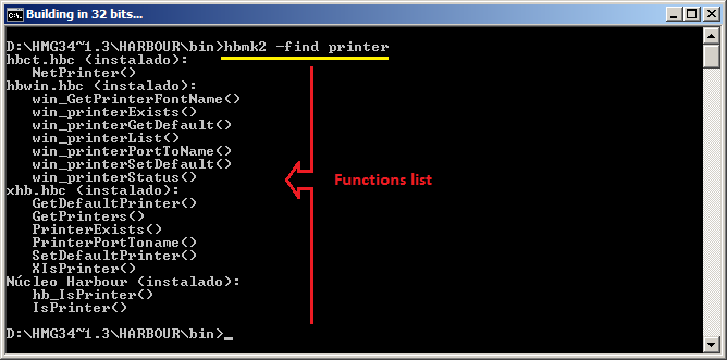

HbMk2 using to know any function/command at Harbour exists
I wish to share with you what Hazael (Qatan) has mentioned in other forum.
Very useful when we want to know about any function or any command at Harbour exists. Thanks to Viktor.
Just type at line command:
hbmk2 –find printer
Will bring all functions list with printer in it. It's accepting wildcard (*) too.
You did not understand. It's a tip:
But sometimes it does not work. Only works after typing: hbmk2 -comp=mingw -find printer
