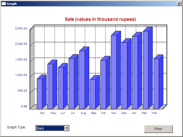

Hi All,
I just wrote a program to show the output in graph (from the data generated from my good-old Clipper/xHarbour+gtwvw program!!!). So my clients can use it as an add-on. :) Here is the code for it.
I created two arrays aSer which is array of series, ay which contains y values.
I started to write the code from Graph_3 of samples folder. So, it's basically a modified demo. But, modification is so much that I want to share it with all of you.

One thing more. In HMG, if the values are larger than 999,999,99, SHOWXVALUES will show you "*"s. So, I just divided my values with 1000 :)
Please advise how to improve the graph generation software. :)

I am sending a working sample for creating graph. Please compile and run :) (And please don't forget to send your advice) :)

sudip wrote:
... don't forget to send your advice
You know, improvement is a very very long way :)
Only some random thoughts :
- You can eliminate unused main (frmsg) window, such as
   CalculateGraph()
return nil
( Don't forget changing MODAL property of GraphTest window to MAIN )
Or my be better, extract CalculateGraph() function and move its content to Main()
- You can acquire graph data from a table, instead of producing by code.
- You don't use SERIES possibility. You can use it f.e. by defining "Cost", "Sales", "Profits".
But don't expand it very much. Samples must be compact, simple and easy to understand as far as possible.
Best Regards

I copied the code from one of my latest add-on project for good-old clipper (now xharbour+gtwvw) apps. Yesterday I started this project and as soon as I created my first graph, I wanted to share it with everybody and posted in the forum!
Mr. Grigory Filatov helped me in solving one problem in graph (value greater than 99999.99 shows "*"s). Thank you Grigory Filatov. :)
Today, I finished my small add-on project and it is created with HMG. It can create Bar, Line, Point graphs and Pie charts from tables of my old apps :)
