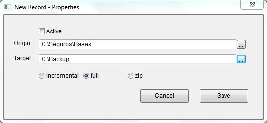

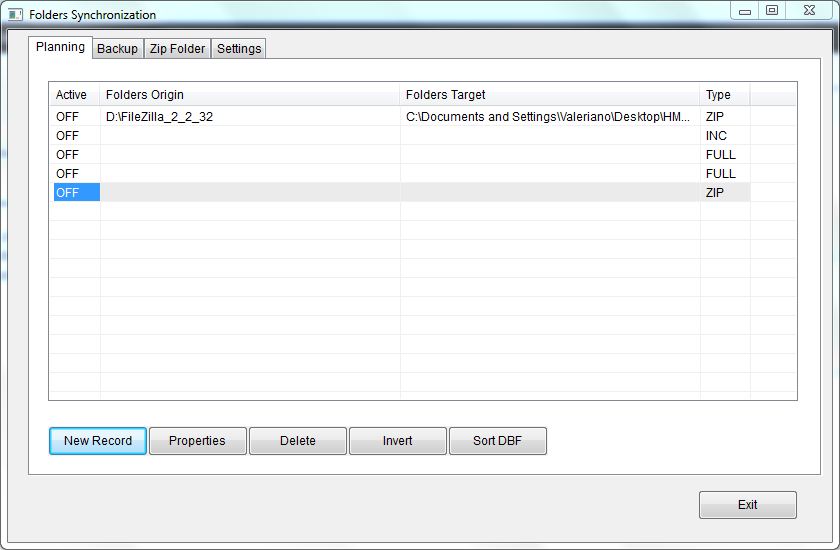

Brunello Hello, thank you very much for sharing.
I can compile the project from HMG.3.1.1, hit New Record, indicated the path of dbf tables, indicated the destination folder but does not save the data, different methods probe INC, Full, with the same result ZIP
I use Windows 7 Home Premium 64.
Hola Brunello , muchas gracias por compartir.
puedo compilar el proyecto desde HMG.3.1.1, presiono New Record, indico la ruta de las tablas dbf, indico la carpeta destino pero no guarda estos datos, probe los distintos metodos INC, Full, ZIP con el mismo resultado
utilizo Windows 7 Home Premiun 64.

Daniel:
have selected active?
Esgici:
how you've set?
Brunello

I'll explain:
1. New record
2. select origin and target (empty fields Target and Origin will be ignored)
3. select the type of backup
4. save
when you want to save changes flag active in the "ON" switch on back page and press Save.
Will be processed only records "INC" and "FULL" with the active flag to "ON".
At the end automatically "ON" will be "OFF"
for zip passing on the page and press compress.
Will be processed only records type "ZIP" with the active flag to "ON".
Setting max zip zip files must be> 1.
He should be between 5 and 10.
This is because for personal experience staff I learned that only one backup file is suicide.
Remember when doing backups to floppies?
enough that only one was unreadable and farewell backup.
My 20 GB then save them incrementally on four different partitions in less than a minute. Several times a day.
Brunello
