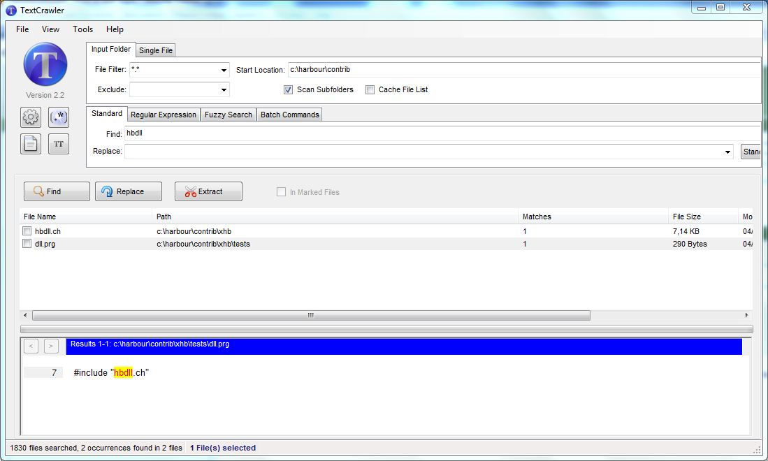

looking into the Harbour changelog.txt HBDLL.CH as I find I need to work with. DLL I prepare to search through and find an example TextCrawler.
 * $Id: dll.prg 18414 2012-10-31 13:04:01Z vszakats $
#require "xhb"
#include "hbdll.ch"
IMPORT STATIC MessageBox( hWnd, cMsg, cText, nFlags ) FROM user32.dll EXPORTED AS MessageBoxA
PROCEDURE Main()
   ? MessageBox( 0, "Hello world!", "Harbour sez" )

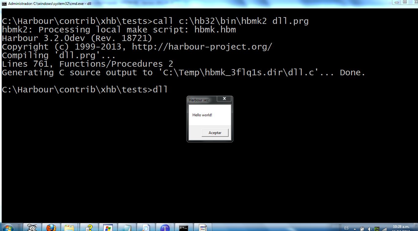

Administrador Cwindowssystem32cmd.jpg (98.12 KiB) Viewed 3517 times
anyone know or have other examples to apply hbdll?
