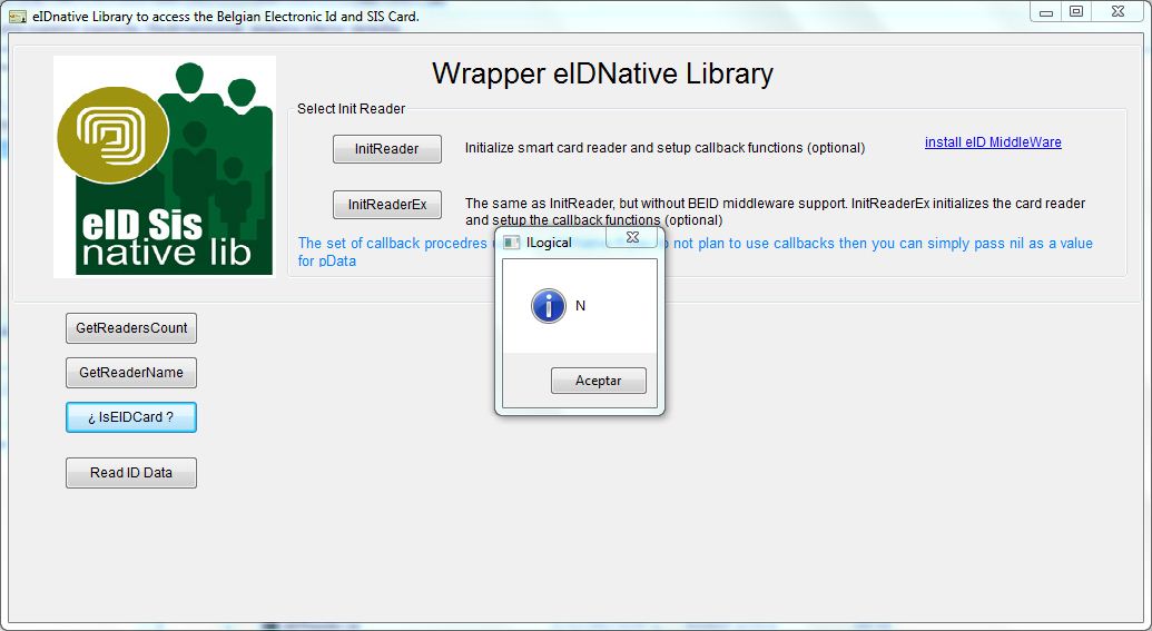

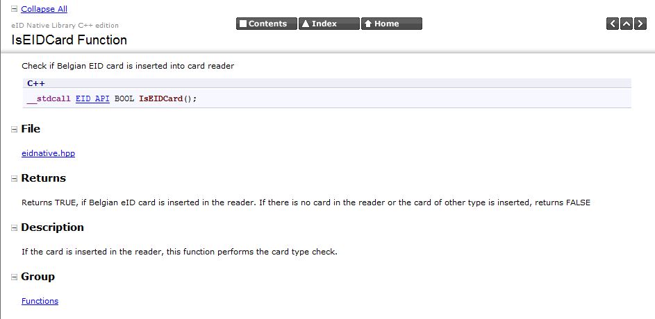

Hola a Todos / Hi Everyone:
Agregando la interfaz grafica me encuentro que una parte del programa falla.
Adding the GUI I find that part of the program fails.
el manual de referencia dice / reference manual says :
el codigo que genera ese error es este / the code that generates the error is this
la funcion es esta. / function is this.
aqui la imagen del error. / Here the image of the error.
tengo una variable NUMERICA antes que un variable LOGICA, no encuentro el error, algunas de las funciones retornan valores correctos y eso me hace perder y dudar que estoy haciendo mal.
esta es la aplicacion completa gracias por la ayuda.
I have a numeric variable rather than a logical variable, can not find the error, some of the functions return correct values and that makes me doubt lose and I'm doing wrong.
This is the complete application [attachment = 0] eIDReader.rar [/ attachment]
thanks for the help.

Procedure ReadDataCard()
Local lLogical := ReadIDDataCard( oeIDIdentity )
msginfo( VALTYPE( lLogical ) , 'lLogical')
If lLogical
eIDReader.cReadData.Value := 'Read identity information from Belgian eID card is OK'
/*oeIDIdentity
eIDReader.cName.Value := oeIDIdentity:cName
SavePhotoAsJpegCard( 'image' )
eIDReader.eIDImage.Picture := 'image.jpg'
msginfo('Read identity information from Belgian eID card' , 'False')
Function ReadIDDataCard( DATA )
' Name: Function ReadIDData
' Input:
' ByRef Data As EIDIdentity - EID Identity information
' Output:
' TRUE when information is successfully received from the card;
' otherwise returns FALSE
' Purpose:
' Read identity information from Belgian eID card
' Remarks: None
Return ( CallDll32( 'ReadIDData' , cDll , DATA ) )
