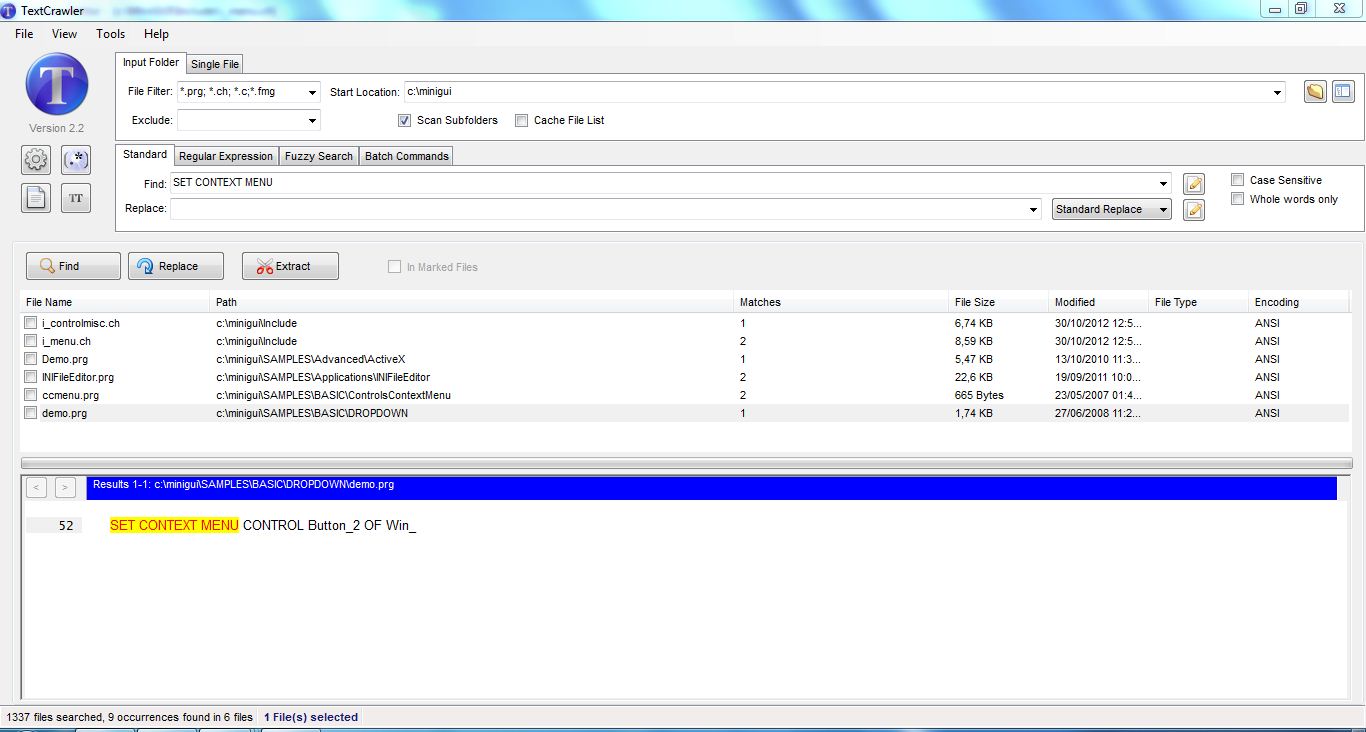

Hace tiempo necesitaba este tipo de control para mi aplicacion con "Tab", para ser mas practico era necesario utilizar el boton derecho del mouse y llamar al menu contextual de dicho control, pero no pude.
utilizando TextCrawler mire un poco dentro de las tripas de Minigui y encontre esto.
Como el Ejemplo de MYBUTTON se puede integrar en el formato UCI. :mrgreen:
mire aqui : c:\MiniGUI\Include\i_controlmisc.ch y tambien en c:\MiniGUI\Include\i_menu.ch
Hello Pablo Cesár:
Long ago this type of control needed for my application with "Tab" to be more practical was necessary to use the right mouse button and call the context menu of the control, but could not.
using TextCrawler look a little into the guts of MiniGUI and found this.
MyButton Example As can be integrated into the UCI format. : mrgreen:
Look here: c:\MiniGUI\Include\i_controlmisc.ch y tambien en c:\MiniGUI\Include\i_menu.ch

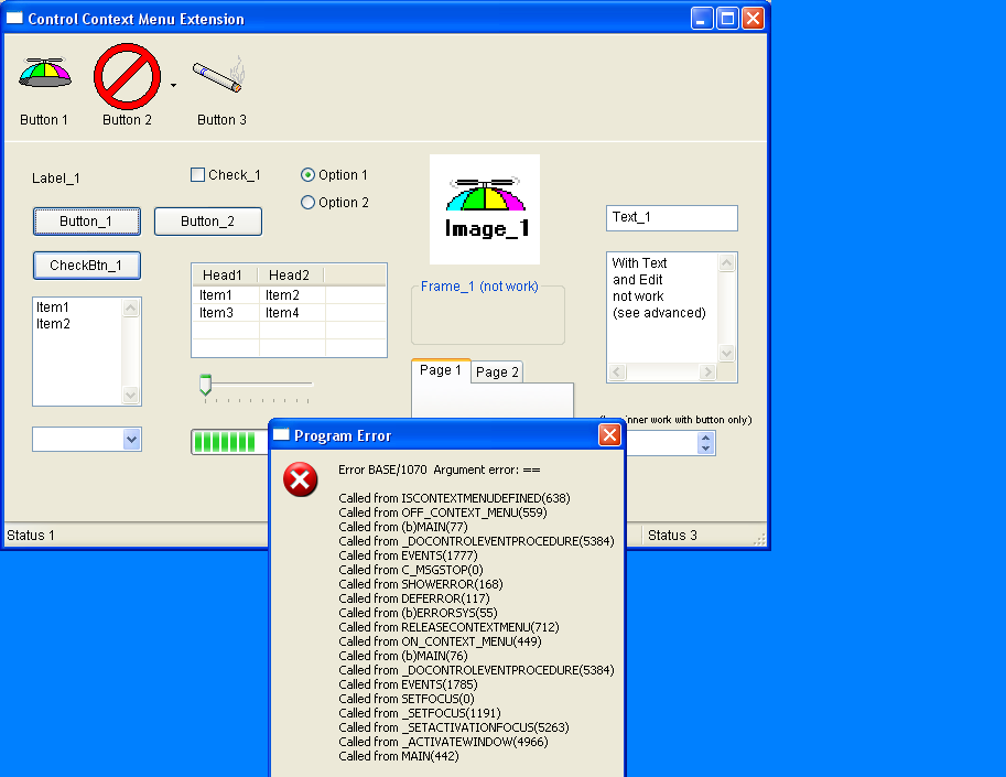

I have tested with other components and its returns a error (see image below):

Pablo César wrote:Now with new implements of ContextMenu options: IsContextMenuDefined and ReleaseContextMenu we can manage diferent ContextMenu. But the problem I did not found the way to run properly with other components. It is working for Button and Form. Please note:
I have tested with other components and its returns a error:
Hi Pablo.
Maybe lack the menu patch viewtopic.php?p=25991#p25991
Best regards,
Claudio.
CONTEXT MENU
srvet_claudio wrote:Maybe lack the menu patch viewtopic.php?p=25991#p25991
You are right Dr. Soto ! Thank you for your reply and support. I was thinking no patch was necessary in 3.1.2 version. But this patch is mandatory. Is it necessary another patch to be applied (upto now) after release of 3.1.2, Mr. Claudio ? (just for me to know and make reminder to Mr. Rathinagiri for next releases).
