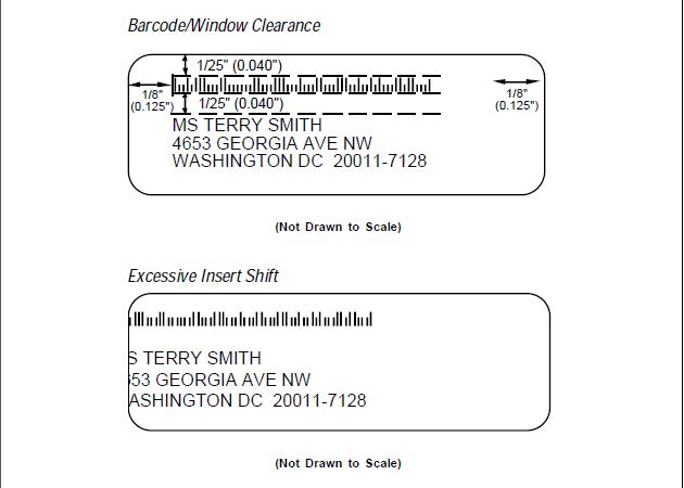

This Found / encontre esto : http://pe.usps.gov/cpim/ftp/pubs/Pub63/pub63.pdf
Page 8
Zint sourcecode :To automate this process, all Postal Service FSMs were equipped
with barcode readers to enhance the speed, accuracy, and efficiency
of processing. The barcode readers ignore all alphanumeric
printing and read only POSTNET barcodes

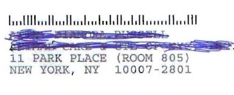

Hi. Thank you for the responses. I took a break from this for a week+, and am now just getting back to solve this problem.
I see that Marek developed code in 2008. Does anyone know if this code can easily be converted to create the USPS bar code required.
I have attached a sample of what I am looking to do (above the mailing address on the invoice).
Thanks.
Mark
