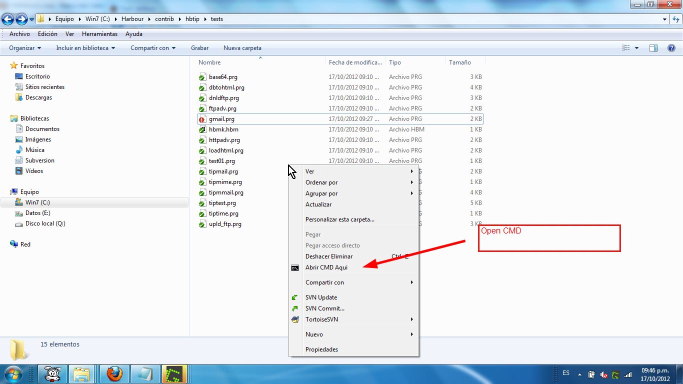

4) go to the folder C:\Harbour\contrib\hbtip\tests open a command window.

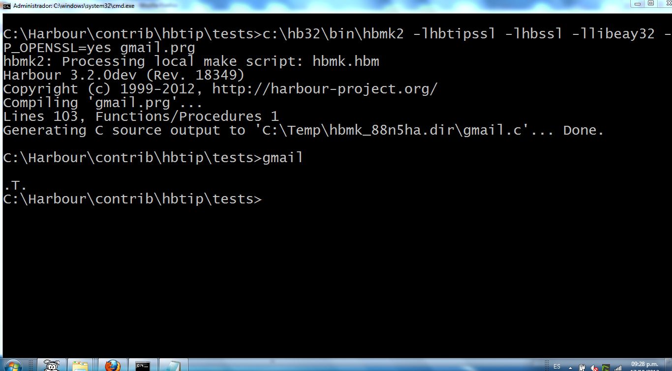

5) from the command line , Then run gmail
c:\hb32\bin\hbmk2 -lhbtipssl -lhbssl -llibeay32 -lssleay32 -env:HB_TIP_OPENSSL=yes gmail.prg
Administrador Cwindowssystem32cmd.jpg (107.29 KiB) Viewed 9545 times
6) Gmail runs and answer with true on success
.T.

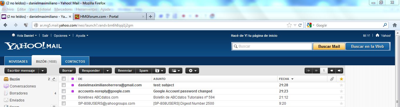

7) check your account alternative or gmail to verify the correct operation.
(2 no leídos) - danielmaximiliano - Yahoo! Mail - Mozilla Firefox_2012-10-17_21-30-16.jpg
(2 no leídos) - danielmaximiliano - Yahoo! Mail - Mozilla Firefox_2012-10-17_21-30-16.jpg (81.26 KiB) Viewed 9545 times

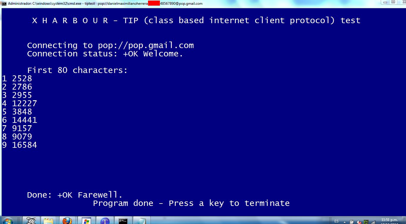

easy but gave many headaches, Tiptest works wonders.
Now to figure out how to read email from Gmail.
