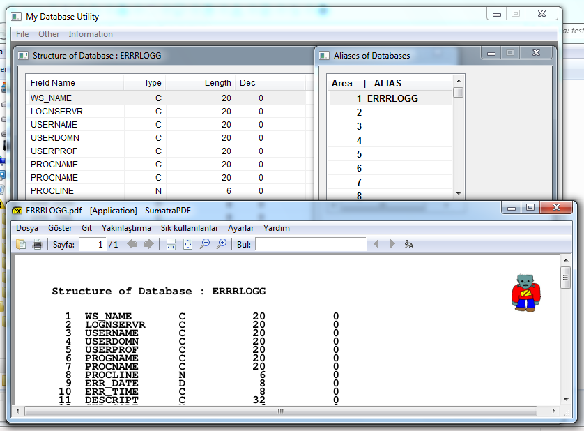

Appereantly you aren't new in neither programming nor HMG world ;)
We could wait more samples / utilities from you :)
Screen shoot of Klaus DBU
