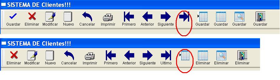

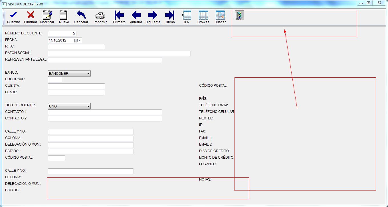

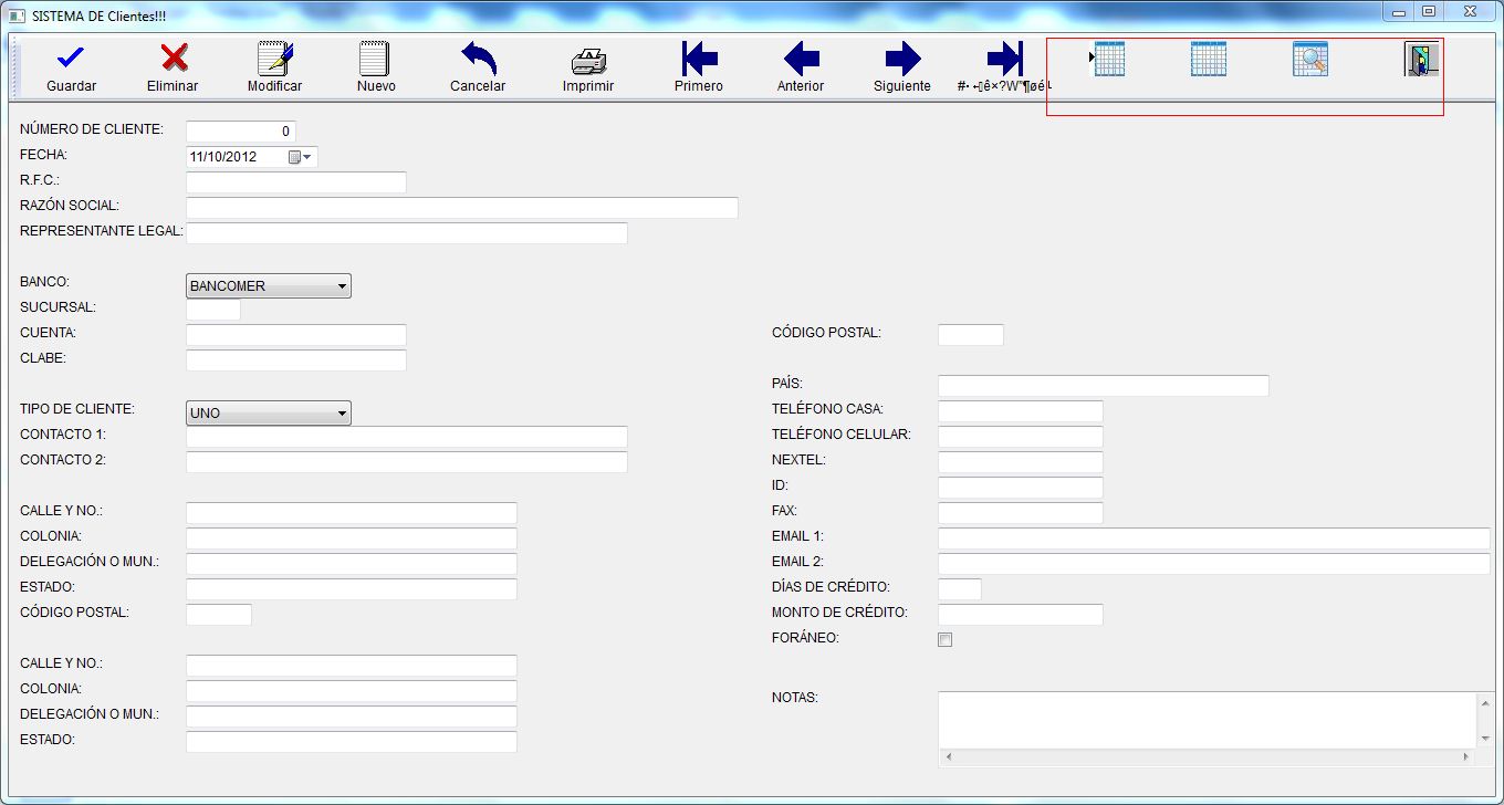

el TOOLBAR con 14 BOTONES solo muestra 9 de ellos y los siguientes pierde el CAPTION.

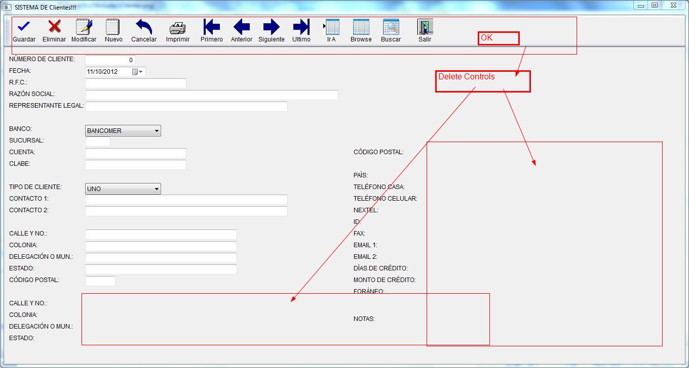

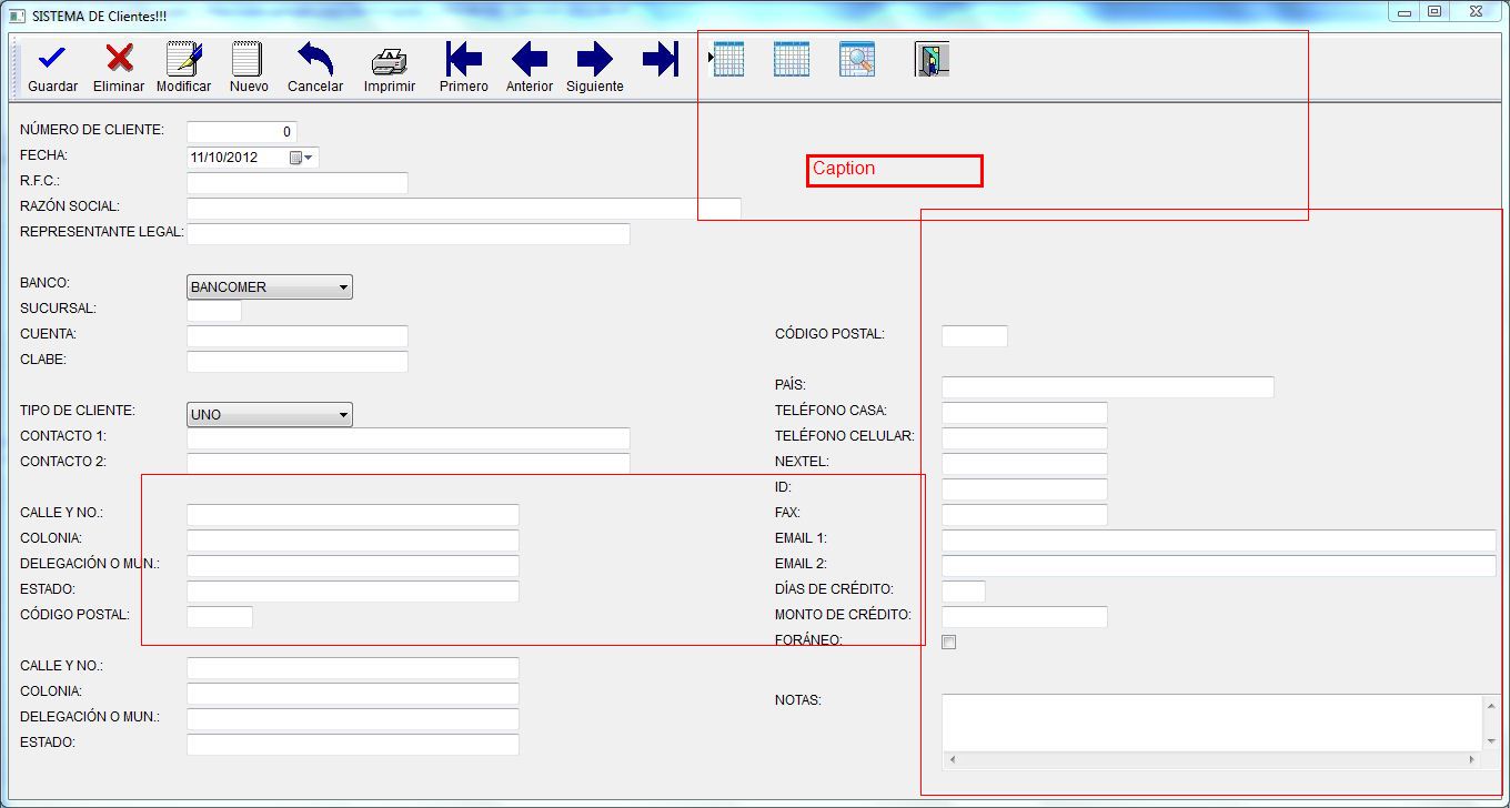

probando varias cosas me encontre que la falla se debe a la cantidad de CONTROLES que contiene la VENTANA.
sacando algunos controles hasta que el TOOLBAR muestra la totalidad de sus BOTONES sin ningun error.
cuantos CONTROLES soporta un VENTANA alguien sabe ????
dejo las imagenes.

The toolbar with 14 buttons only shows 9 of them and lost following CAPTION.
testing various things I found that the failure is due to the amount of controls contained within the window.
removing some controls until the Toolbar shows all its buttons without any error.
WINDOW CONTROLS few supports anyone know????

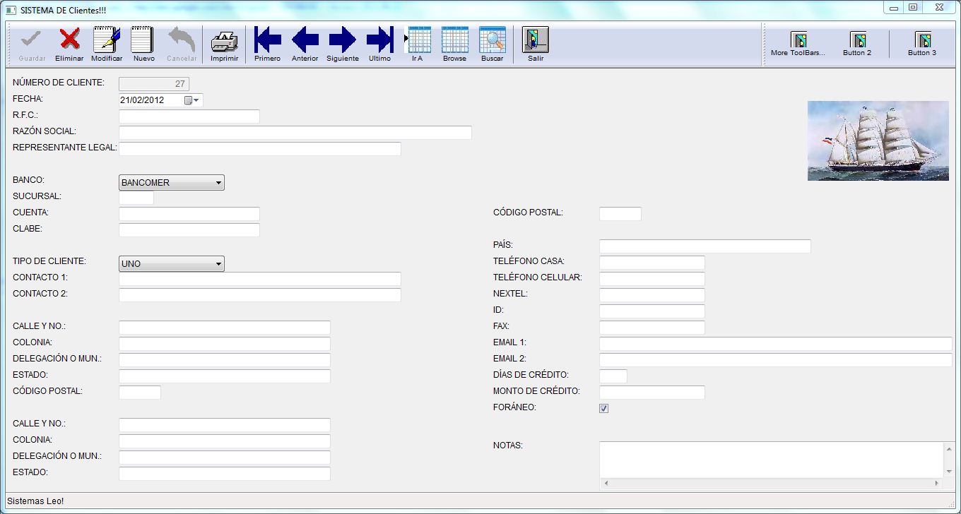

Sorry, I was wrong.
This is in XP, the bug is always in the button number 10.
Claudio.
Claudio.
- daniel_xp.JPG (49.09 KiB) Viewed 5574 times
