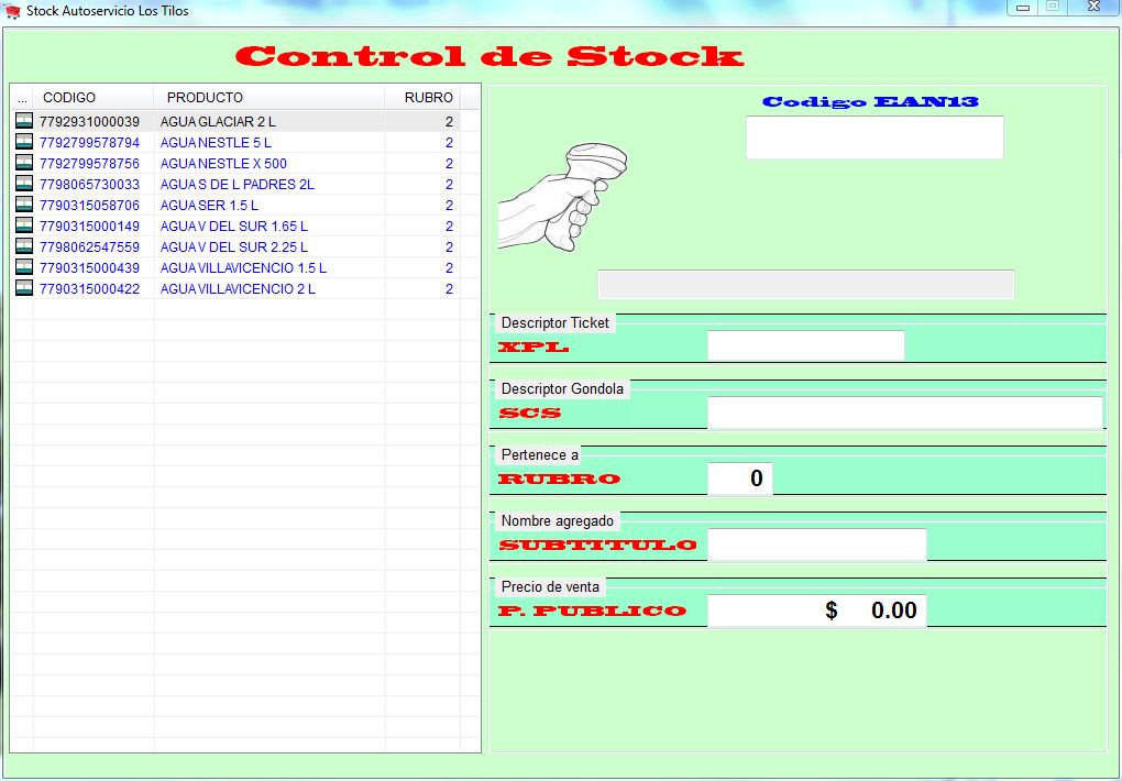

Hi guys:
looking at the forum, I found several ways to filter a table.
some with SET FILTER TO or ORDSCOPE as some faster than SET FILTER
wanting to apply it to the grid unresponsive see, I'm doing something wrong, or need to supplement with some other function???
Procedure Filtar()
Local cDesc := ''
cDesc := UPPER( InputBox ( "Buscar Artículos", "Buscar : " ) )
cDesc := AllTrim( cDesc )
If .Not. Empty ( cDesc )
  PRODUCTOS->( OrdSetFocus( "SCS" ) )
  SET FILTER TO cDesc $ Productos->SCS
  Stock.Articulos.Refresh
Endif
income in the inputbox 'shampoo' to filter the grid with this article and ignore.

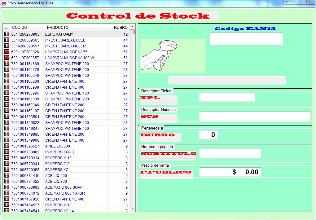

Hi danielmaximiliano !
Please, try this code:
Procedure Filtar()
Local cDesc := UPPER( InputBox ( "Buscar Artículos", "Buscar : " ) )
  // Bag Order: make sure it exists
  Productos->( OrdSetFocus( "SCS" ) )
  // Initial and Final range filter
  Productos->( ordscope( 0, cDesc ) )
  Productos->( ordscope( 1, cDesc + 'Z' ) ) // Try to remove + 'Z' after test
  // Top of File
  Productos->( DBGOTOP() )
  // Browse Data
  Stock.Articulos.Refresh()
Endif

Re: Order in a Grid
Funciona Perfecto :
muchas gracias Ronaldo
