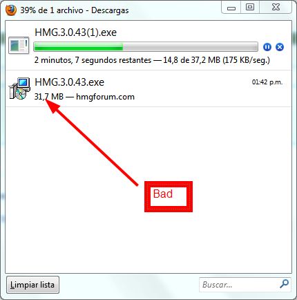

Gracias Rathi:
como siempre tengo que descargar desde :
http://sourceforge.net/projects/hmg/fil ... irror=ufpr
algo debe suceder en mi maquina o mi ISP (Speedy - Telefonica.com.ar)
Re: HMG 3.0.43
Posted: Thu Aug 30, 2012 5:23 pm
Yes, for somebody download from HMGForum site is not complete because of unknown reasons. That's why I have uploaded in SourceForge.net also.

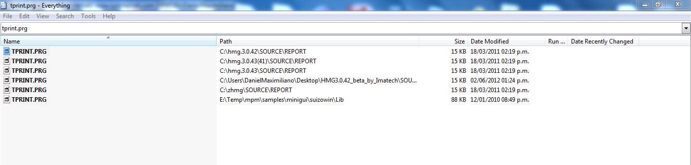

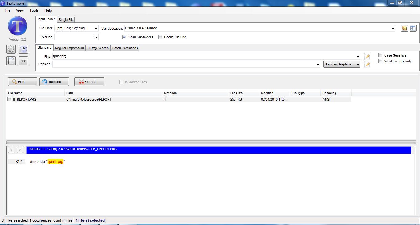

Why exist this deprecated, unnecessary and problematic command on end of file: H_REPORT.PRG ( line 814 ) ?
#include "tprint.prg"
Please: remove it from source ( H_REPORT.PRG line 814 )
