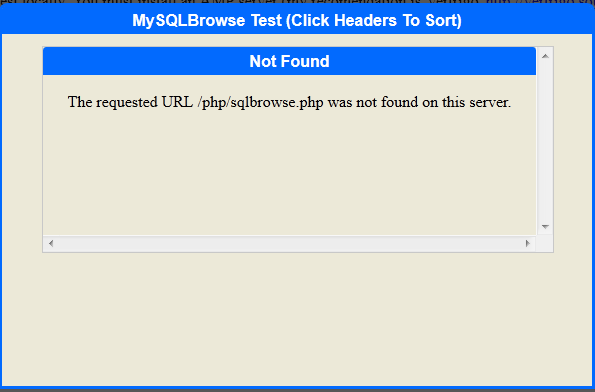

hola a todos:
no se como conectarme con el vertrigo
pues copio los archivos www en la carpeta C:\Program Files (x86)\VertrigoServ\www como se haria con el wan server
no me funciona la conexion mysql
como lo haria?
en la ruta hmgscript/www/ me arroja en browse error 404
gracias muchas gracias
como lo haria?

Re: HMGSCRIPT 0.36
maybe, because the script has no rights to ../dbf folder.rathinagiri wrote: - I am getting a 404 error while running xBase demo. Don't know why!
You could try move the test.dbf file to the same folder as script is, and remove the ../dbf/ of the following line in browse.php:
$dbf = new dbf_class( '../dbf/' . $file); Regards/Saludos,

Re: HMGSCRIPT 0.36
The account must not be necessarily root (of course) but must have the required rights to access to the test database and be able to do CREATE, UPDATE, INSERT and DELETE operations.rathinagiri wrote: I can't run the MySQL and xBase demo as such because,
- We can't have a root user account in MySQL online. (may be we have to change the user from 'root' to 'demo' and try).
