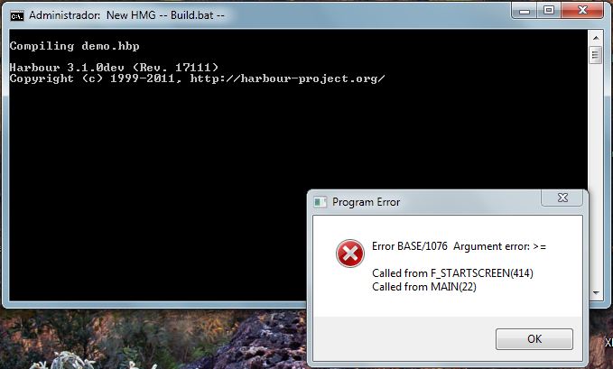

I´d try to compile and run the demo but with no success.
I am using: Windows 7 64 bits and HMG 3.0.40
Please, take a look at the attached file
[]´s Salamandra

Hello Sr.: Salamandra
Here I have the same ambient as you have used...
Win7 64
HMG 3.0.40 (Just Downloaded for this test)
Copy files to: C:\hmg.3.0.40\SAMPLES\HMG_WVG
CMD (Prompt)
C:
CD \hmg.3.0.40\SAMPLES\HMG_WVG
Build demo.hbp
Build ok: no any warning's (Demo.exe attached with sources updated)
Please: For your test, edit build.bat and correct the path...
call \hmg\build.bat %*
to
call ..\..\build.bat %*
M., Ronaldo

I tried it with your bat file and compiles fine, but runtime error remains... :(
May be something related to HMG version ??
[]´s Salamandra
Re: HMG 3.x + WVG = Harbour Multi GT
No. Please try to compile thru IDE. It´s works !
Post by IMATECH »
Maybe You have an invalid lib:gtwvg (Null Return of oScreen )...
Please try do DownLoad a new HMG 3.x and will have success on this...
Best regards...

the path of my current HMG is: C:\HMG.3.0.41
this installation does not contain any default, might have crossed path with MiniGUI, harbor and / or other post-installation HMG HMG.3.0.41
To verify this, open a console
Type "Path > path.txt"
Type "Notepad path.txt"
in Notepad go all the way of his variable% PATH%
