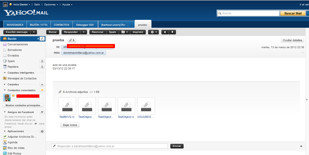

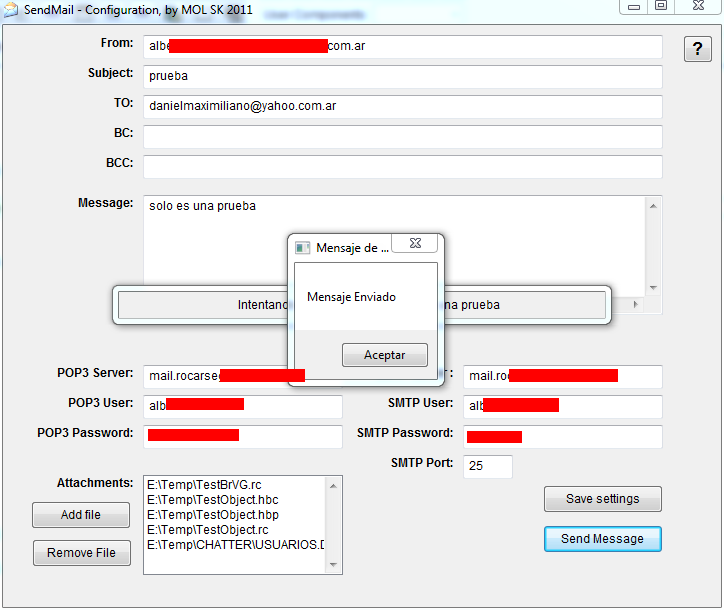

SendMail - Configuration, by MOL SK 2011_2012-03-13_22-38-32.png (61.87 KiB) Viewed 5780 times
(4 no leídos) - danielmaximiliano - Yahoo! Mail - Mozilla Firefox_2012-03-13_22-40-23.png
(4 no leídos) - danielmaximiliano - Yahoo! Mail - Mozilla Firefox_2012-03-13_22-40-23.png (79.07 KiB) Viewed 5780 times
