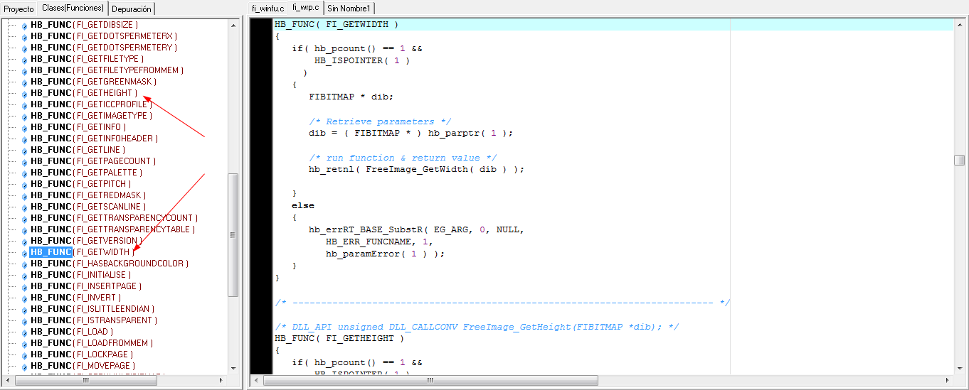

Hello Mol:
you need to use contrib Harbour HBFimage

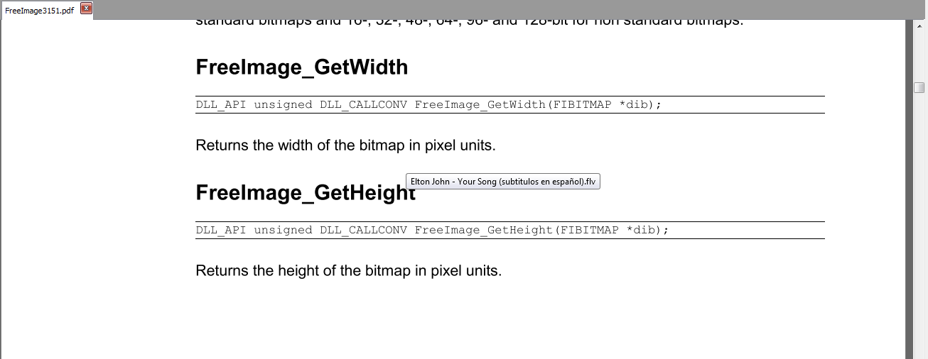

Hi:
PDF Freeimage project : http://downloads.sourceforge.net/freeim ... ge3151.pdf
