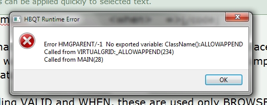

With this new directives, the application will compile ok, but will generate a runtime error:

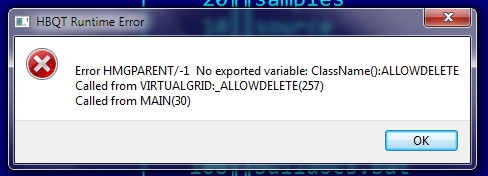

Re: About Browse Compatibility...
Francesco,
Now, another runtime error arises:
The sample app. still the same.
mrduck
Posts: 497
Post by mrduck »
Now it should work
mrduck wrote:Now it should work
Roberto Lopez wrote:Francesco,
It is working now.
Thanks.
